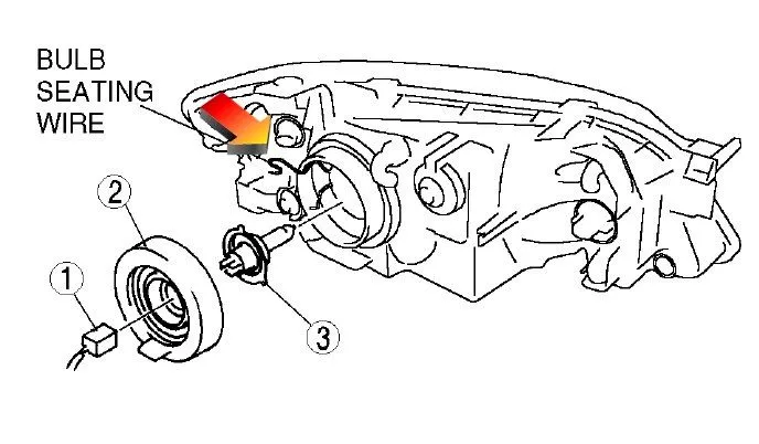

i coudlnt get the metal paper clip liek thing back in so i just electrical taped thebulbs in, is that really bad? haha they seem to be alligned really poorly now haha.
uh yes... tape is bad. You have to bring the clip over towards the bulb and up wards a bit. Hard to explain but try and pinch the square part of the clip in so that you can hook it into place.

As other said, your bulb wasn't in properly. Its not the best design in the world. I pulled the car up in front of a wall after I swapped out the bulbs and I noticed one was low (and dim) too. I came up with a little trick to make sure they're in properly. Put your hand on the back of the bulb and then look through the headlight lens from outside the car. You want to see the entire base of the bulb all the way around the hole where the bulb pops through. Then its seated properly.
Oh, and the pic in the manual is your best bet on figurinng out that clip holding the bulb in place.

The white plug attaches to a black plug that the bulb attaches to. You can feel the black piece behind the rubber gasket.. unsealing the rubber gasket makes it a lot easier, then just separate the white plug from the black plug, get that big rubber thing out of the way, and then you can see the clip more easily. Do the driver's side first, it will make doing the passenger side less painful.

the wire clip that holds the light in place... well i managed to break the plastic tab that holds the wire clip in place, and then i dropped the wire clip down inside the headlight... it just baffles me as to why they would make a whole seperate design for the low beam, rather than duplicate the same design they used for the high beam, which is 1000 times easier!!! so WTF am i supposed to do now? is there a how to on how to remove the whole headlight assembly? i need locations on all the screws/bolts
