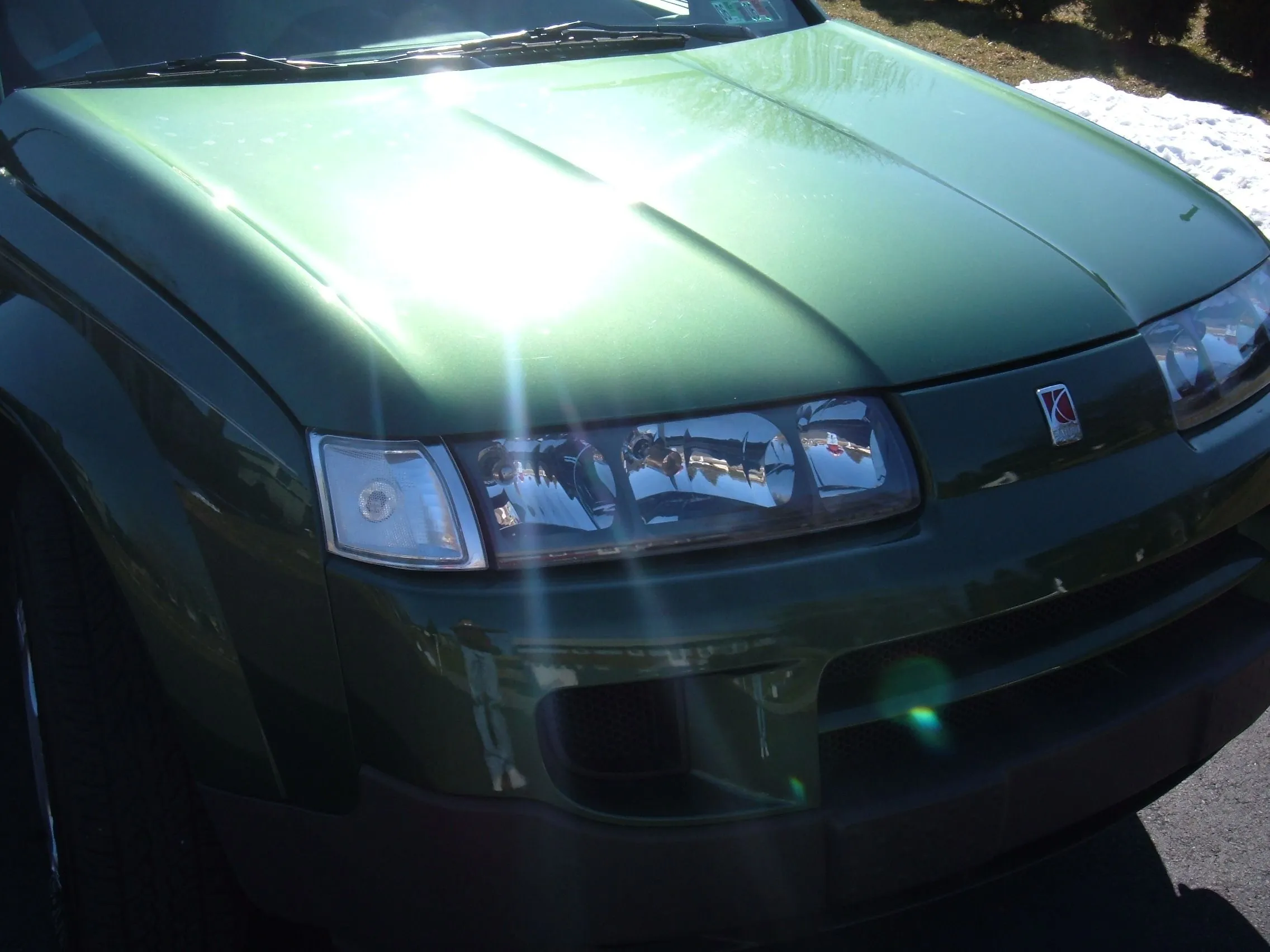

Clear corner lenses...yes, but make sure your bulbs are amber. Unless you want to be pulled over. To help keep the 'clear' look get some clear led's that light amber. Like this...I apologize for the Saturn pics but I don't have have clear corners on my P5 :)
Confusion said:
Its legal to have clear corner lights right ?
You don't say where you are located, but in most cases it isn't. They must light up in an amber color even if they appear clear when not lit.
A lot of states have their laws listed on their DOT websites. Try that!
I've done searches on the Texas site several times when I wasn't sure what their take would be. I love pissing off the local po-po because I am juuusssttt inside the law and they can't touch me. The blue RockBlockers are such an example, as is the front plate delete (displayed in the windshield.) I get the best double takes from some of them now.
(enguard)
(rlaugh)​
^^ I can almost guarantee they aren't legal, but if you put amber lights in them you should be ok. Depends on how your state handles inspection. You may have to swap back to your other corner lights before an inspectoin date.
^^^You should be ok with those. They are just like the corners I put on my Vue and I went through inspection with no problems last year. The key is to get the amber bulbs. I bought mine at Autozone for around $10.
