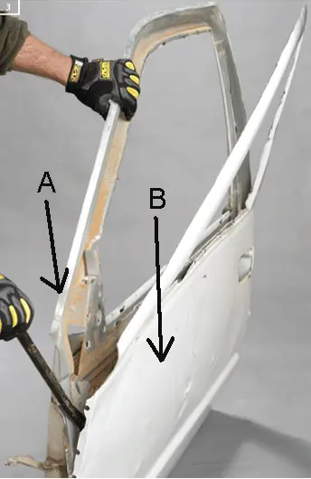

the carpet will be fine.... the door panels, you actually want the deadening on the doorskin, not the inner part. The most important thing when putting in deadening is hitting the FLAT panels.
Could you explain what you mean by "doorskin" vs. the "inner part"? Would it be "A" or "B" in the attached picture? From what ive seen in this thread, everyone has attached the soundproofing material to "A"
i think he means on the inside of the plastic part, well that's what i understand correct me if im wrong.
aznsebass - cover your bases and put it on both. In his video on the first post of the thread, Matt shows it on B. BUt he also put it on the inside of the interior paneling which is what I think fred_spitfire is calling the plastic part and there is a picture of this on Matt_V's first post.
I believe the doorskin is B. A is the inner metal portion (that you hang your speakers on). The door panel is the plastic interior portion that you see when you're driving.
ok i think i just got it ... he placed some on the inside of the plastic we can see when we're in the car, then he place some on the inside of B AND a bit on A around the speakers. OP am i corect ?
i feel like i'm in science class but for cars and only one damn diagram lol
