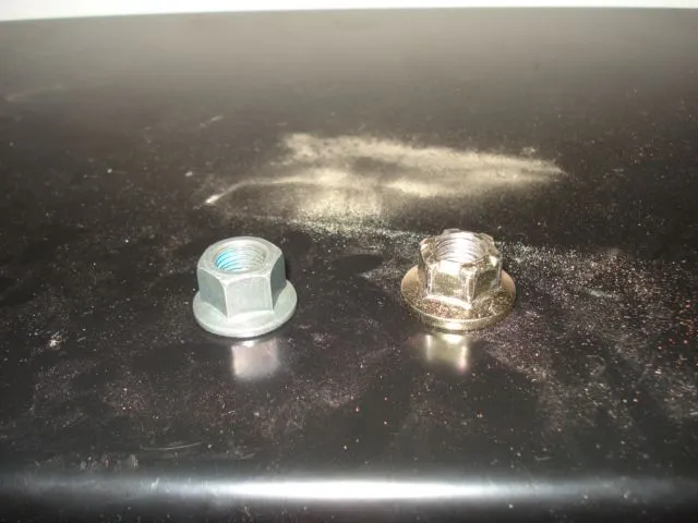

bumping an old thread....I know. Installed new struts and springs couple years ago with no problems. I forgot to reinstall the dust boots. So here recently, I decided to uninstall the strut to put back in the dust boots. I have all nuts as tite as they will go, but now everytime I go over bumps, the strut shaft will move up ever so slighty causing the bowl shaped washer and the regular washer(for the washer trick when using lowering springs)to become loose just for a sec and clunk against each other. Both sides are doing this. I uninstalled everything and installed it all back and it still clunks. I guess i've uninstalled everything too many times as now both bowl shaped washers on the flat side, have rounded off. I have new ones on order. Anyone have some insight here?

OEM nuts for the strut shaft. The aftermarket ones don't have enough "material" under the threaded portion of the nut and you have to use a washer(s) to get the entire assembly tightened up (or in your case ... not (lol2)). An OEM nut for each rear strut assembly will solve your issue.
I thought I was using oem nuts....? What do they look like? Any of these oem?
