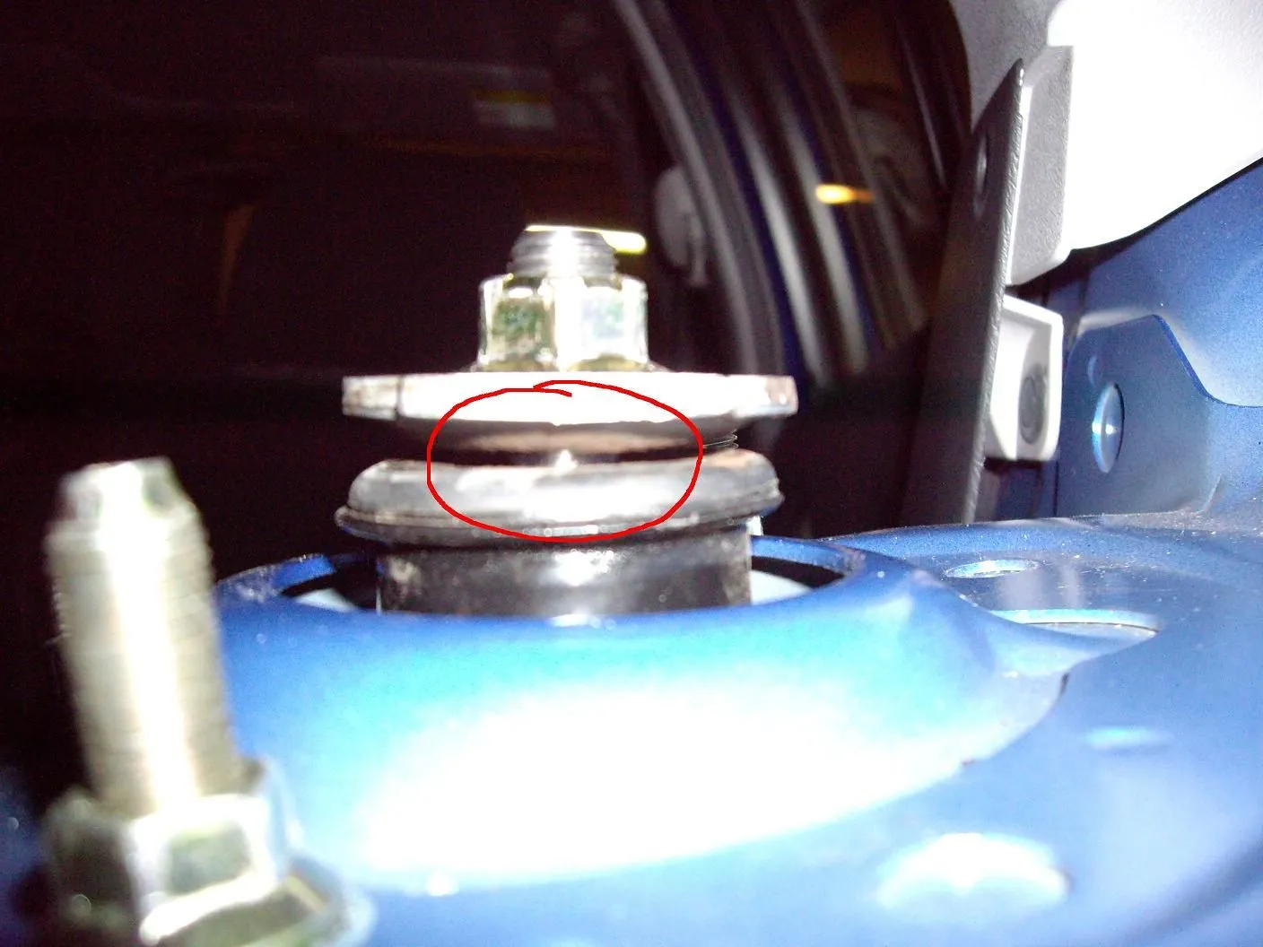

Help!!!
I need help guys! After installing my Tokico HP struts, on my P5, the rear doesn't seem right. There is a gap between the washer and the top of the plate that it is suppose to sit on. The piston of the strut rotated when I test drove it. It seems like the piston of the strut is too long or something. Did this happen to anyone else? What happened and how can I fix it?
The center nut that comes with the Tokicos has less material beneath the threaded portion and will not allow full tightening of the assembly - reuse the OEM nut or throw a washer or two beneath the Tokico nut.
Okay thanks for the suggestion. I'm gonna give it a try tomorrow morning. However, shouldn't the washer fall to the bottom and touch the plate regardless of the nut?
It should. It can get hung up if you don't line up the corresponding flat spots on the ID of the washer with the strut.
Bala - Thanks for your help! The washer got shifted when I originally put on the nut. I undid it and it was wedged up on the threads. Had to hammer it back out but now its flush with the bottom. And for good measure I used the OEM nuts. Thanks again!
