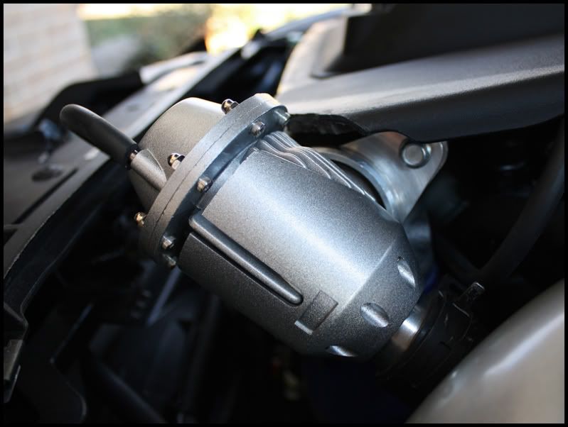

before i install my boost gauge, can you send a picture where the vacuum hose is. i know it is a stupid question but i want to make sure before i cut it.
thank you.
I used the hose that goes to the Bypass valve. That is the plastic piece at the front of the engine bay that is right off the intercooler. Take the plastic intercooler cover off and you will see it right away. Just cut the vacuum line that goes to that and insert a T-fitting. Connect the two cut ends of the vacuum line to the two side fittings on the T and then run a line from the top fitting to your boost gauge.
EDIT:
You can see the vacuum line in these pictures I took today:
The stock BPV will look different than the one I have (the RKM unit), but it (and the line) will be in the same location.
