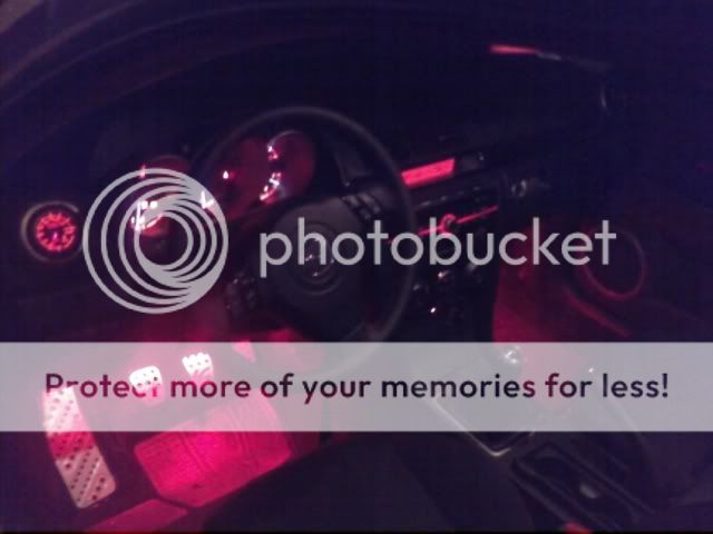

they're actually not as bad as the pics made it seem. brightness is perfect. they're not neons. they're leds. they do not get in the way whatsoever when driving at night and do not distract you while driving. i didnt want to get blinded by neons or extra bright ass leds so i got em done a lil differently. color match is perfect. looks like they came stock on the car. ppl are like woah other cars should come like that. im like i had that done to it lol (headbang)

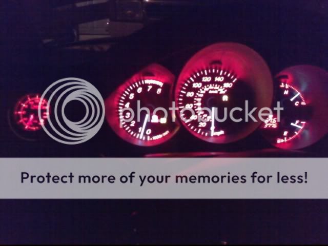

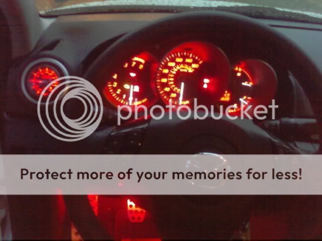

bad cell phone pics. the lights arent pink they're red. gauge matches nicely. my setup is prosport premium boost gauge with rpm store's ventpod
Kinda looks like the car is on fire, literally
