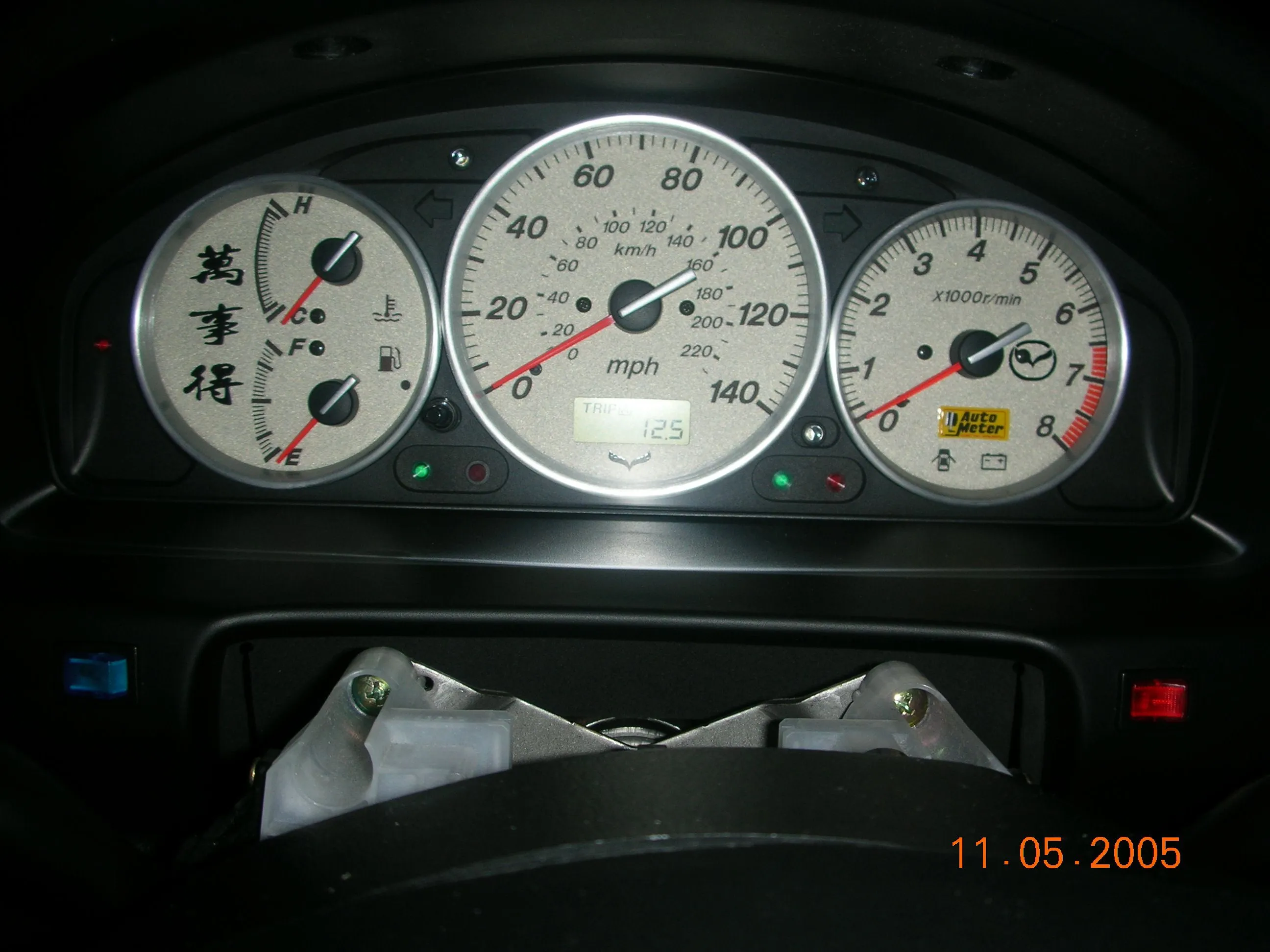

I wish that I had seen this before. I had to replace my cluster because I fried one of the door relays when hooking up some side dash lights. I have added about 8 leds for diff. things.
They are as follows from left to right:
red led for fog lights on/off
blue led for dome light on/off
green led for a/c on/off
red led for alarm
yellow led for rpm shift light
blue led for sunroof open/close
green led for hood open/close
red led for trunk open/close
I also added the Dave B Rings, painted the center line on the needle caps, added auto meter sticker, added japanese/chinese masda stickers and flying M mazda sticker.
Here it is installed in the car.
http://www.mazdas247.com/forum/attachment.php?attachmentid=95588&stc=1&d=1164683019
The 2 swithces are for brake lights (red) and reverse lights (blue) on/off
