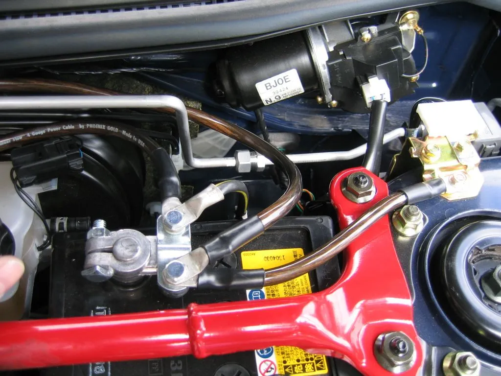

How To: DIY Ground Wire Kit
What are the wire lengths for the grounding kit if I was to make my own..
The link on the first page is not working..
I don't know them off hand, but your best bet is to find out where you want to ground them. From one point, then trace it to the next with measuring tape. Continue until you get the amount that you desire. The car in the HOW TO is an older model (2nd Gen maybe) Protege, so you don't want to come up short.

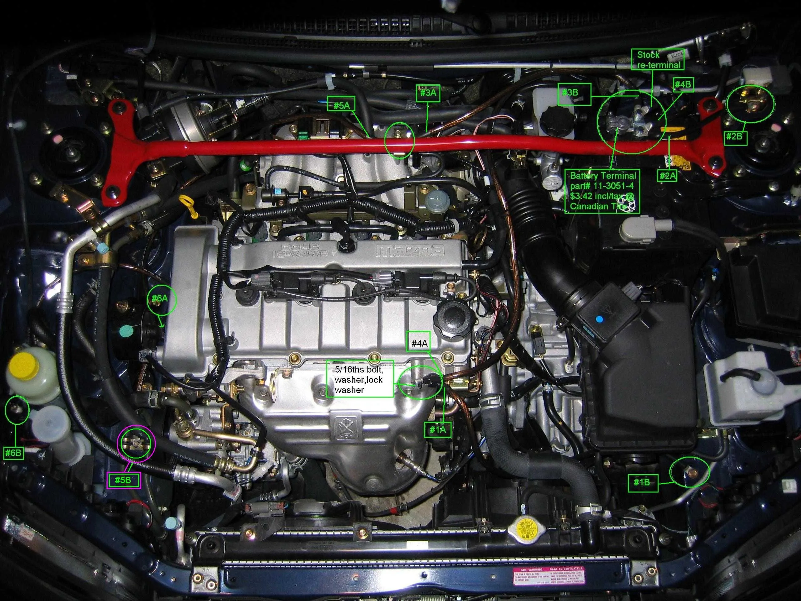

my local protege club had a ground wire install meet today. here are the instructions.
copied and pasted from a post by niv, one of our members on mpsport.net:
Ground wire Install:

How To:
1. Cut wire to needed lengths - youll need 6 lengths. (these add up to 11 ,
so if you want to put that extra on one of them Id do it on #4 or #5 wire.)
a. 1 = 22
b. 2 = 7
c. 3 = 23
d. 4 = 33
e. 5 = 35
f. 6 = 20
2. You can use the terminal to decide how much wire to strip off the end of
each length. (I did one and it was just a bit more than a inch)
3. Crimp your 10mm 4gauge terminals to one end of the lengths.
4. Lay out the wires like where they are going to live when you are done, and
attach the Point As - the this step is optional but itll make your life easier
when you have to put them in for real .
5. Youll have to cut the factory wires from the terminal ring and put a new
10mm 4 gauge terminal on. (its the black wire with the yellow stripe that
disappears under the battery. Cut this as close as you can to the terminal
ring as youll need all the wire you can get)
6. Once your wire is lying the way you want, add the rest of the 10mm 4gauge
terminals to the remaining wires except for # 1,4, (5/16th) and 6 (17mm).
Make sure the terminal is lying the way you want as well, then crimp.
7. Put the 5/16th terminals on #1 and #4. and the big one on #6
8. Cut shrink wrap to 1 lengths and place over terminals and wire. Now is the
time to use that heat gun!
9. Put the new battery terminal on. (I dont know if it matters which way you
orient it, but if the terminal attachment point side is toward the left strut
youll probably have an easier time attaching #2 wire.
10. Attach the rest of the B points now.
11. For #6 B point if you remove the bolt holding the power steering fluid
reservoir, youll be able to get at the bolt for #6B easier.
12. Zap strap the wires into place, all nice and pretty.
Note* I didnt have an alarm on the car at the time of the install, and you are disconnecting the battery so you will reset your ecu and have to reset all your radio stations, as for the alarm I dont know what youll have to do. Turn it off when it starts beeping I suppose.
sorry for the ultra-big picture but it'll help those who are lost.
result?:
idle rpms down and gas mileage up! :p butt dyno tells no tales. :(
EDIT: 5/16th bolts, washers, lock washers should be 8mm.

1Canuck2 said:
Where's 5B? Same spot as 6A I assume, but just checking...
lol.. thanks for that question.. i forgot to put that in. now added in eye-sore magenta!!! :)
they aren't the same site.. and now you'll see
sorry bout that....:eek:

So wait now Niv, aren't you missing a wire? Don't you need one from 5B to 6A? I am confused. I thought the whole point was to bring things back to the stock ground location. How does wire 6 get back there.
In your previous wires, one end of each cable joins to another, right?
1A and 4A on same bolt
5A and 3A on same bolt
3B, 4B and 2A (on neg battery terminal)
But things go from 5A to 5B and end. Then 6A and 6B are off in no mans land. Poor wire 6, no friends and no "real" grounding :(
Correct me if I am wrong (which is highly likely).

Hey Robin,
I should point out first that i'm not the expert on this.. just one of the guys at the install meet who took some pics and remembered the process. :)
no wire is missing now with the updated picture. i didn't show 5b ending.. now it is...
wire 6 is a replacement of a existing factory wire (as you probably have noticed on your own engine), and provides a stock engine & grounding point.
I'm not too familiar with the precise electrics of this theory. But it shouldn't matter if you don't go to a stock location on 5 or 1 as you are merely providing a point of good grounding as opposed to looking for some kind of grounding circuit. As you'll notice attachment point 3A and 5A isn't a stock point.
I think as long as you are providing a route from engine to a reasonable ground point 5B not being stock is ok.
