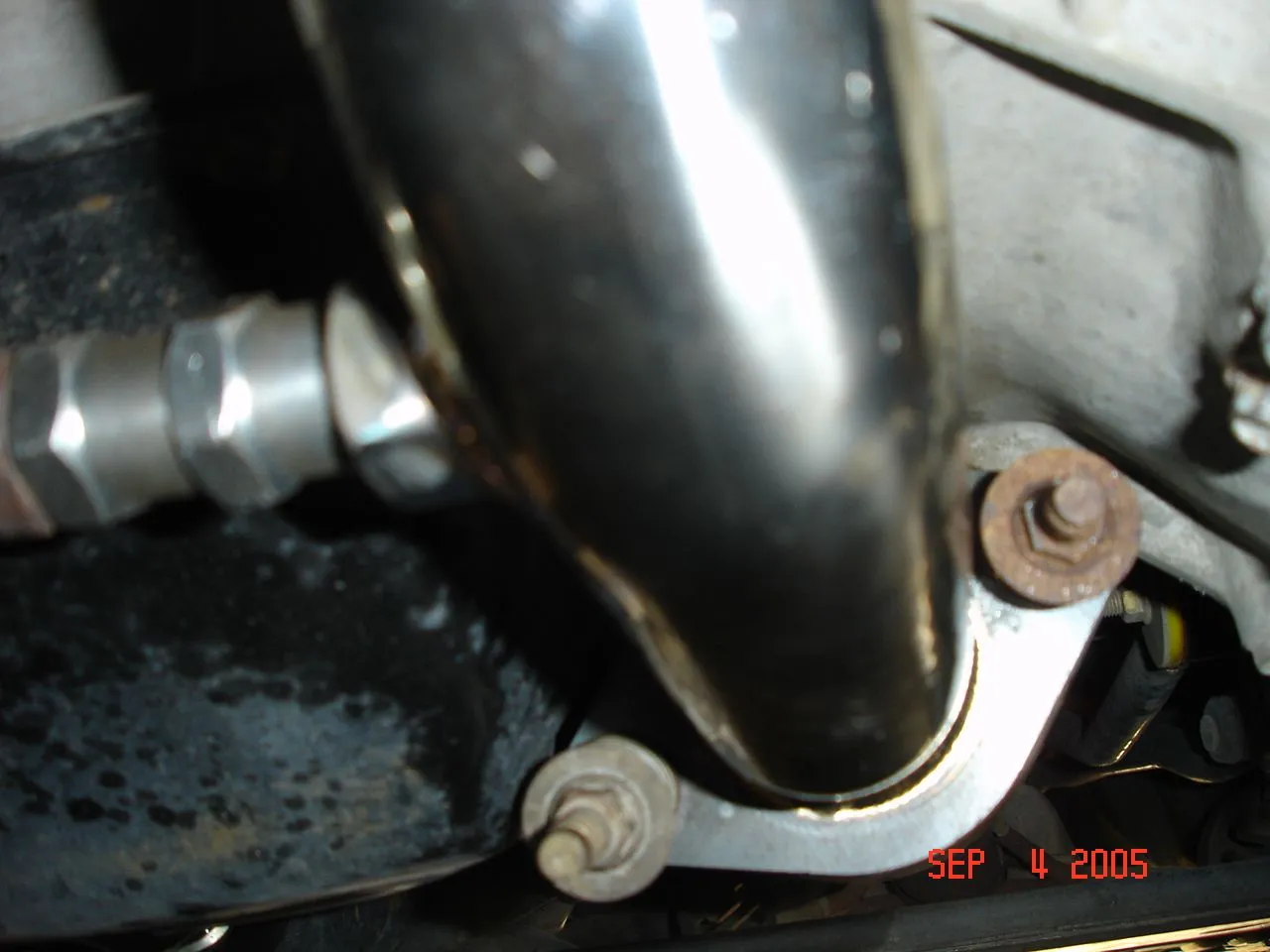

nonfouler i used
This is for an OBX 2.0 header. Like somebody stated before HELP part number is 42008/42009. 18MM. Works great. The drill bit to use is 1/2 inch. Perfect fit.
