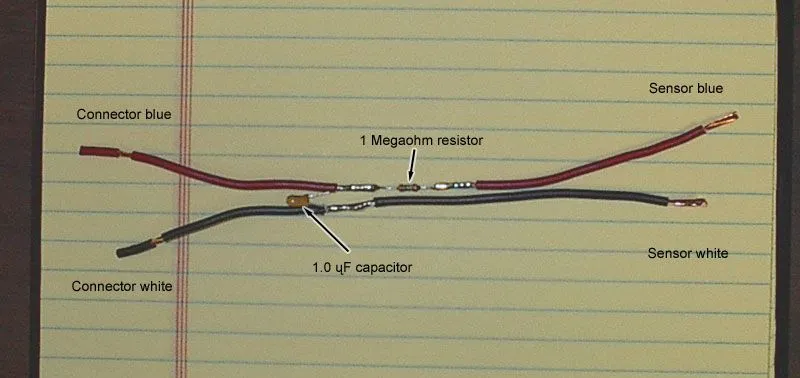

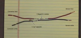

MIL eliminator photo
For any of you that want to see what it looks like before it's wrapped up, I just soldered one together last night. I need to get some heat shrink tubing to finish it up. Just make sure that you wrap the individual lines so that there aren't any shorts.
