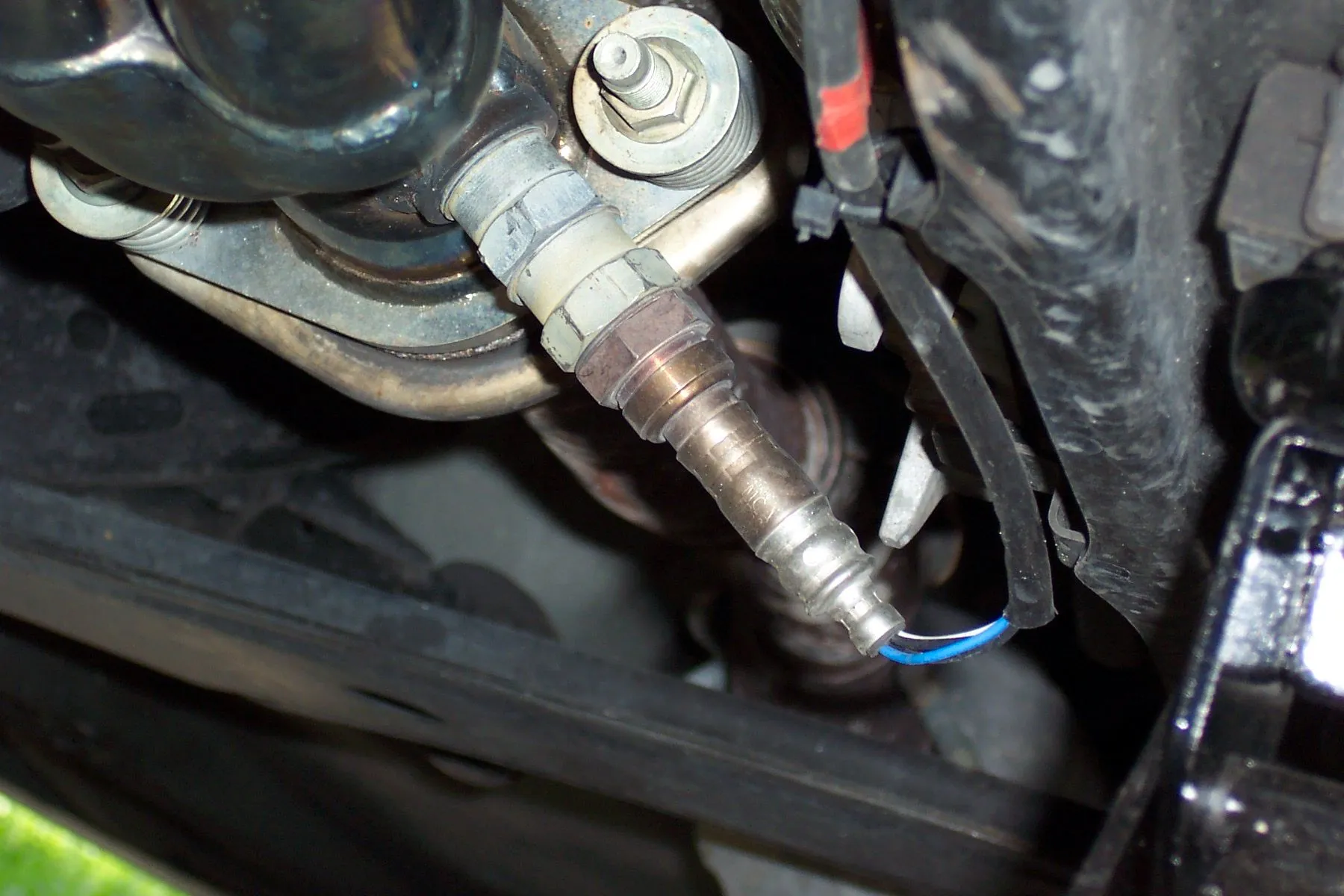

I am getting the second O2 sensor bung welded this week on a ractive header. Has anybody here added the second bung on a ractive header along with adding the foulers to keep the cel away. Let me know. (eek2) (eyeballs)
I have. pic attached.

ok just so i can clarify, u use either the wire/reistor/cap method or u can use the spark plug non fouler method to remove the CEL/MIL issue regarding header install?? and the OBX header has all the right bungs unlike the Ractive header which is missing the second bung??

Do the non fouler, it's save you a few bucks. If you do the non fouler you'll need a 1/2in drill bit to drill all the way through so that the o2 will fit in it. I did it and it works great. There is a how to on here too.
