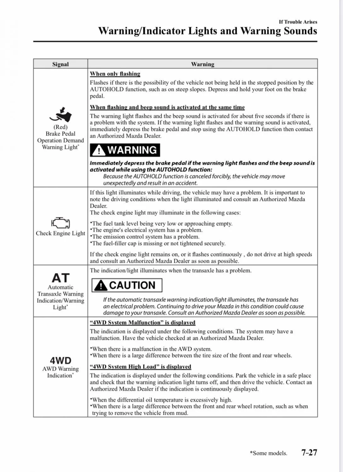

Yes, my 1998 Honda CR-V AWD from Japan does have a tiny “4WD” sticker on rear window which is the only sign to distinguish from the FWD CR-V if we don’t look at the drive train underneath. But remember in our CX-5 it also uses “4WD” as AWD warning indicator and “4WD System Malfunction”、”4WD System High Load”、“4WD System Inspection Required“ warning messages to indicate there’re problems in our AWD system. So I believe “4WD” is a customary term in Japan to represent both AWD and 4WD vehicles.
Good find thank you. Wonder why Mazda chose that terminology for their AWD System warning.
Mazda is simply using the generic terminology for a system that drives all four wheels. Also realize that a lot of the dash and underlying components ~may~ be shared with vehicles that are actual offroad 4WD capable and using a more generic warning covers whats needed to alert the driver AND reduce cost in production.
