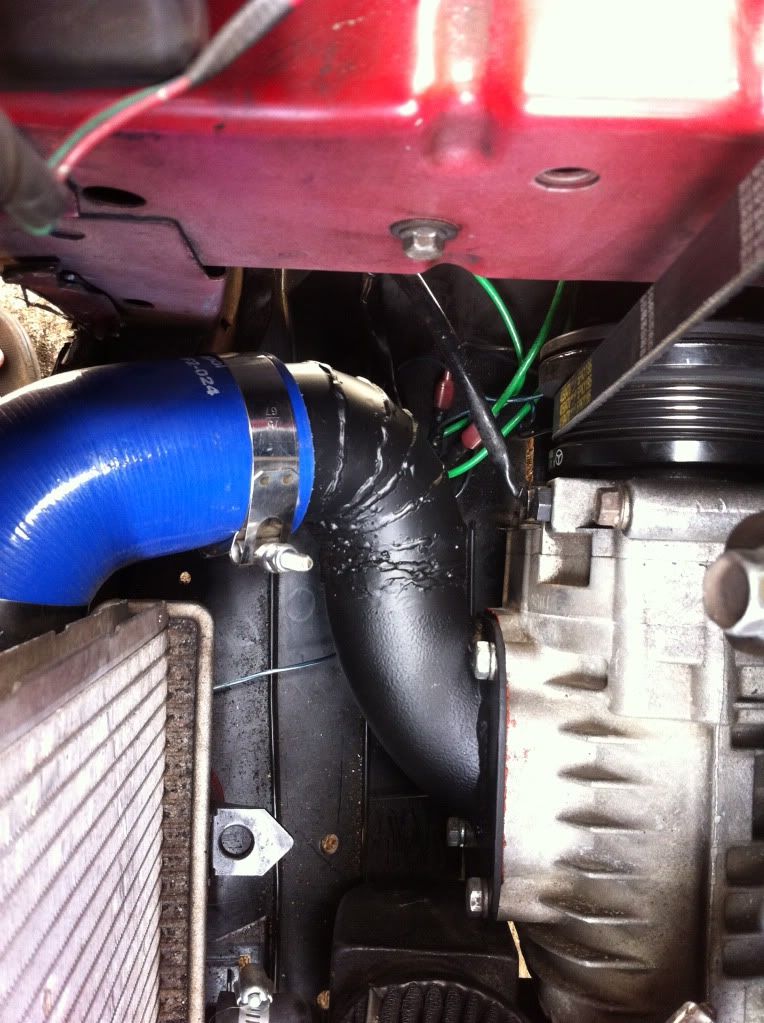

took it out for a spin. only boosting .38 hkpa (6psi) Im loosing 3.5psi somewhere.... I can hear it boost leaking though. I cant hear it unless im under load. =(

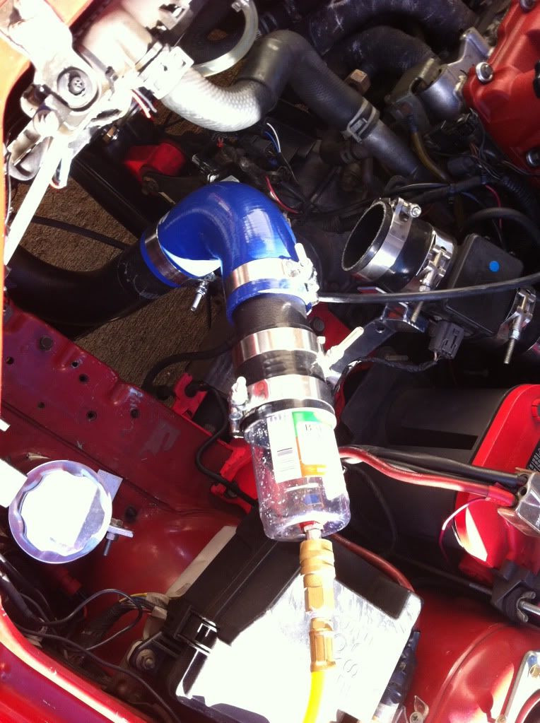

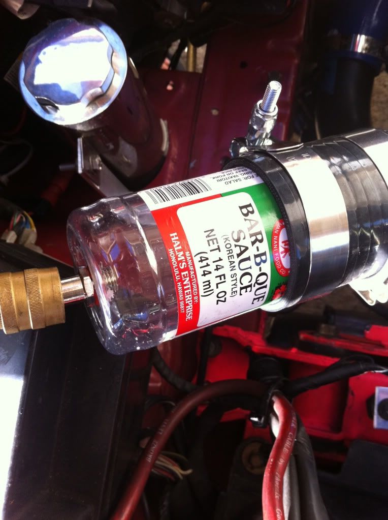

So i went to the kitchen with my silicone coupler and searched for something that would fit. Korean BBQ sauce FTW. screwed in a air fitting and got some RTV. Test went well. Found just one big spot between the SC outlet and SC outlet pipe. (the flat piece, i guess i didnt RTV enough)

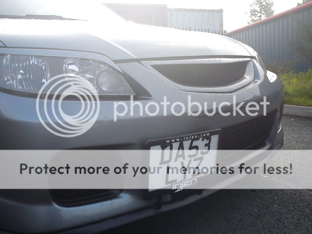

Heres where I put my plate
you can see the ghetto brackets I bought from a diy store over here. i think they where 2GBP each! :lol:
