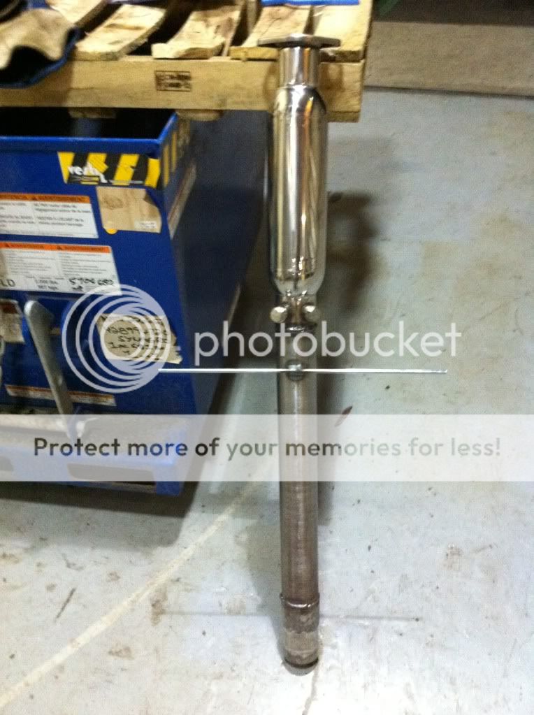

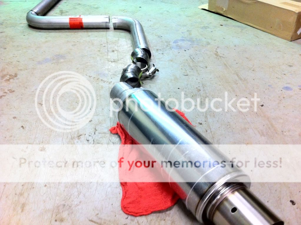

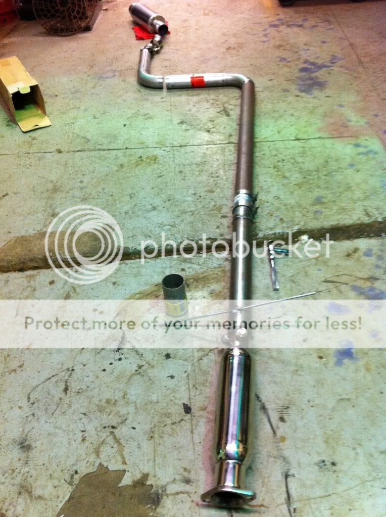

About 1/3 done with the exhaust. Pretty much finished the midpipe (yes that is a Honda Civic High Flow Cat) At the bottom of that, ill be adding a V band flange that will connect to the S pipe.
I already pre cut the two 90* bends and all the straights, I still have to pie cut 2 45* bends, get more hangar material, and weld up the muffler. (N1 Style 2.5 in/ 3.5 out)
