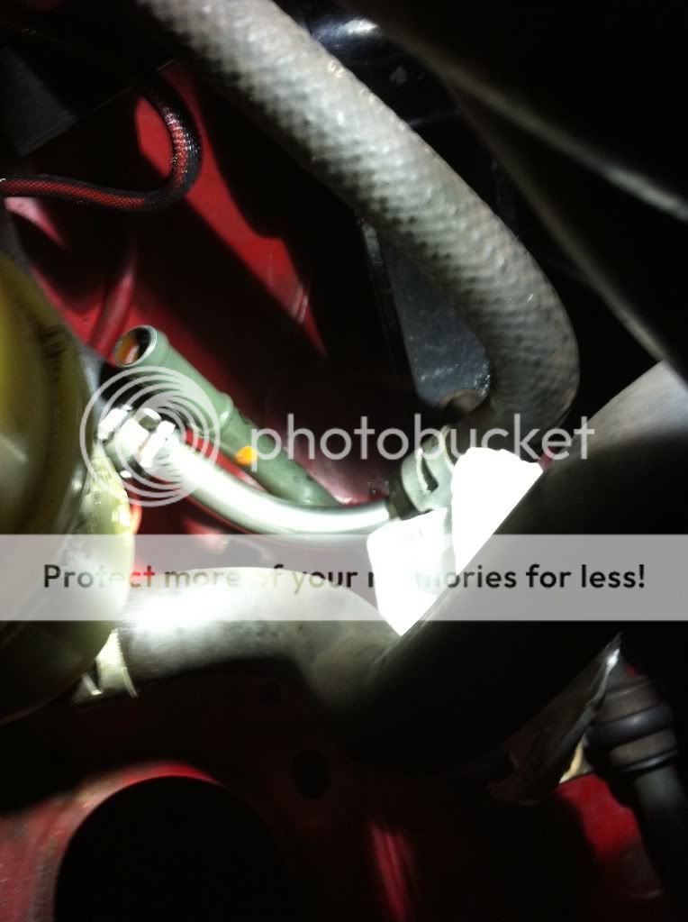

Today I took out the remaining A/C lines. Got some aluminum stock to make a new mounting bracket for my coolant overflow. Going to move it into the hole on the drivers side. this way I can cut near the radiator to fit the ic pipe (trying to go for shortest routing.) Working tomorrow night too. So im sure ill be doing something then. Maybe I get the tank mounted in the new location. Im also thinking of doing a small wire tuck and get all the rubbish wiring that I have done. Going to try and clean up the engine bay as best I can.
Got some little stuff done today. Made the brackets for the IC, Test fit the intercooler. (still waiting one couplers), Took out the A/C evap can, removed the A/C condenser, moved the PS line to fit the IC, and mounted the coolant tank in the new location. Didnt have my phone with me so I couldnt take pics. Tomorrow I should be moving stuff out of the way (cutting) So ill mount it up and take a pic.

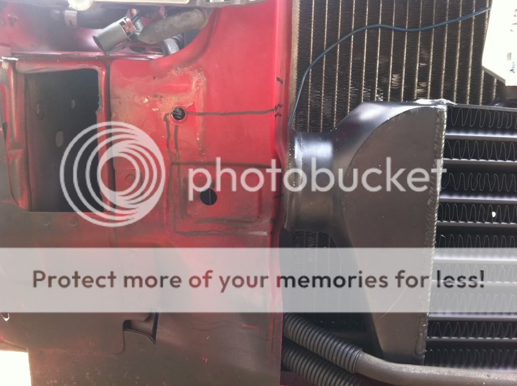

Ok took the bumper off (have it secured with metal ties for easy removal for the next couple of weeks) Mocked up the intercooler core, marked my cuts and made up the intercooler brackets. Tomorrow Ill be cutting into the metal and maybe getting the outlet pipe situated. Its hard working nights when I want to get all this stuff done. lol

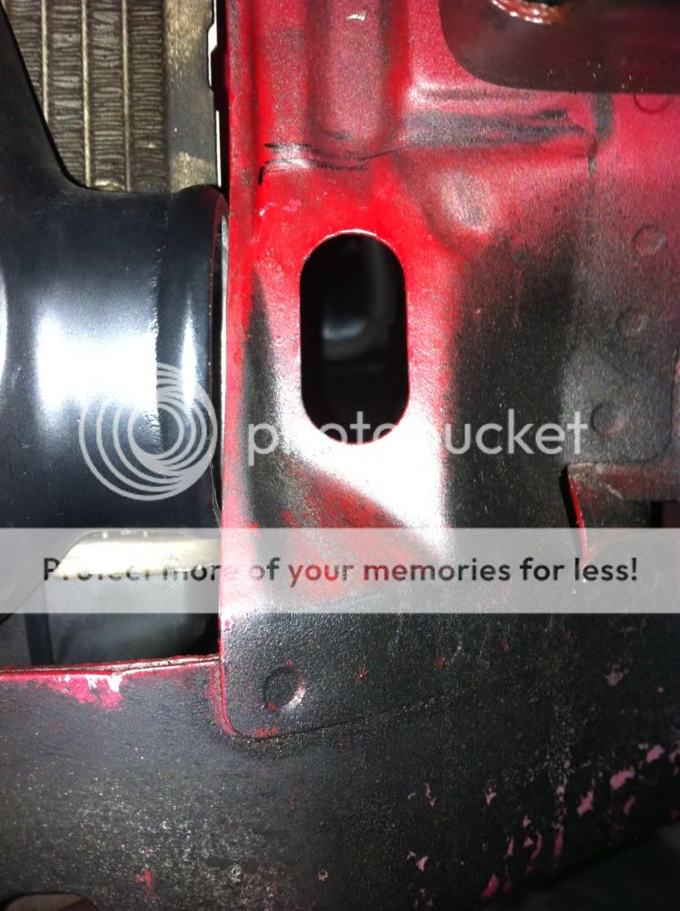

Got the bumper off again, turns out 8am is too early to cut metal..... lol Anyways Ran out of time. Looks like im going to have to do this at work on the weekend. Get the Sawzall and cut s*** up. Once this is over with the next on the list is getting the outlet of the SC to the hot side of the IC. Then getting the cold pipe set up while getting the BOV placed. good times
Deleted the power steering cooler. Now I dont have to cut into the crash bar. (more safe! lol
