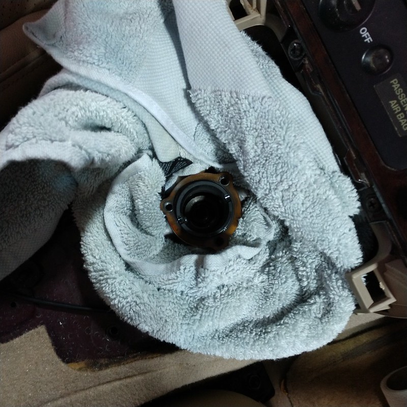

Transmission has been feeling notchy so I figured it might be time to change the fluid. Looked back through my maintenance log and couldn’t find when I had changed it the first time. After perusing my build thread I saw I had done it soon after buying the car. Looked in my log and I had a date/mileage entry with nothing written. I had changed the oil/filter and trans fluid then but for some reason didn’t fill in the log past the date/mileage. Hey, at least now I know what I did at that time (entry has been made)! Turns out the fluid had almost exactly 40,000 miles on it. I ordered new Motorcraft fluid from Rock Auto last week, their price is pretty decent even including shipping costs.
We got a break from rain today so I took her out for a spin to warm things up. Got home, jockeyed cars around, put her in the garage and up in the air. First I removed the center console and shifter (for any who aren’t yet aware the 6 speed transmission can be filled from the shifter hole). Then creeped underneath and pulled the drain plug. While that was going I cleaned up the shifter and other bits. Installed the drain plug with a new washer (Mazda part #99564-1800, it’s the same for both the drain and fill plugs) and then pulled the fill plug. FYI both the fill and drain plugs are 24mm hex heads. Then it was back up top to fill it. I put a towel around the opening to catch any spillage like so:
I did spill a little from the first quart which (naturally) worked its way to the bottom about the time I went back down to install the fill plug. I put in both quarts, only a little overflowed from the fill plug. I lubed up the shifter balls with some Valvoline red automotive grease I had (was going to use white lithium but it wouldn’t come out of the spray nozzle so into the trash it went). I was happy to see that both shifter boots were still in good condition. Finished up with installing the console and topped things off with the new factory shift knob I had sitting around.

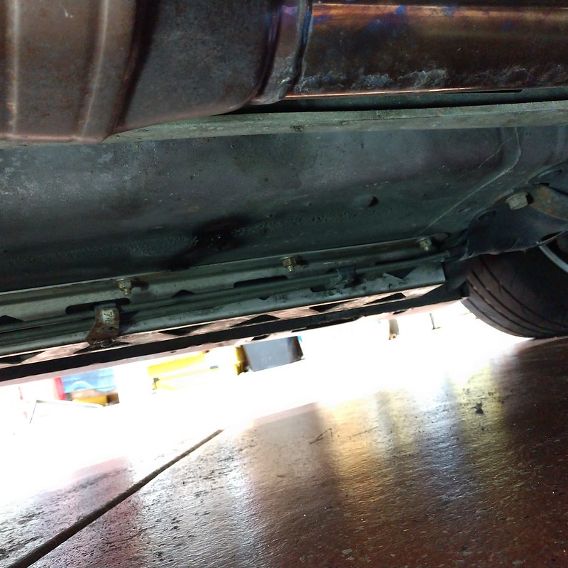

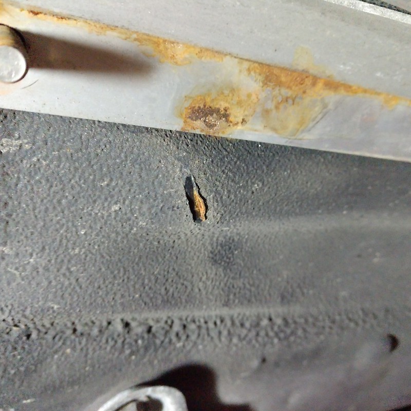

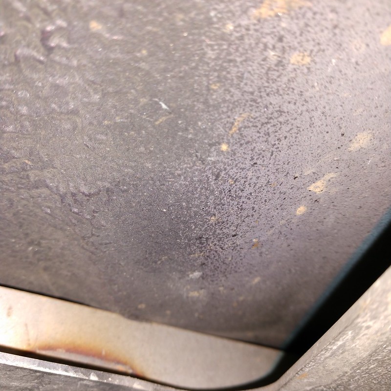

Last week when I was doing the transmission fluid change I looked around underneath as normal. The last time I had to remove the FM butterfly brace center section I left it out to see if I noticed any difference (I didn’t). I had left the wings that connect the center piece to the frame rails. I saw that both sides had a spot where they were hard up against the bottom of the car. Hmm, maybe some transmittal of vibration through them?

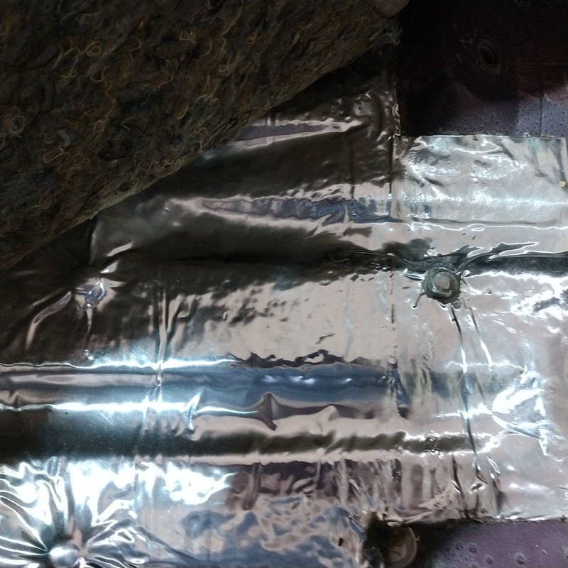

Since they are no longer serving any purpose, I decided to remove them today. Worked on the passenger side first as it is more difficult as you will see. Removed the seat and lower seatbelt bolt along with the side sill scuff plate. This was enough to allow me to get under the carpet to access the top of the bolts. I had to cut away my sound deadening pad in way of two bolt heads:
The passenger side of the frame rail has a couple of studs to reroute the brake line brackets along that side. This is what makes the inner bolts on that side harder to access. Picture from the other side after I did the passenger side wing removal, you can clearly see the lines running inboard of the frame rail.
The job actually went a little quicker than when I installed everything as I now have a 3/8” impact wrench that I didn’t have before. Still took some finagling to get the lines out of the way far enough to access the nuts. Got the nuts all off and removed the wing. Sprayed the spot where the wing was on the body with some Rustoleum aerosol undercoating I had around. Dropped that side and did the same thing on the driver’s side but quicker. Here’s how the contact point on the driver’s side looked prior to undercoating:

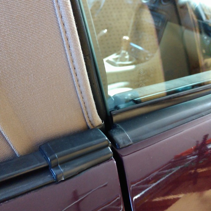

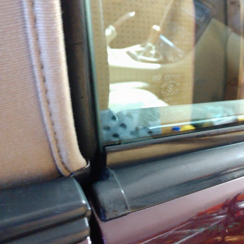

I ended up taking a drive with the top up. I can recommend doing this occasionally so you can find problems you might not otherwise. Interior seems quieter now, however I did notice some wind noise coming from the passenger side at the back of the window. Got home and had a look, there was a bit of a gap between the window and the weatherstrip:

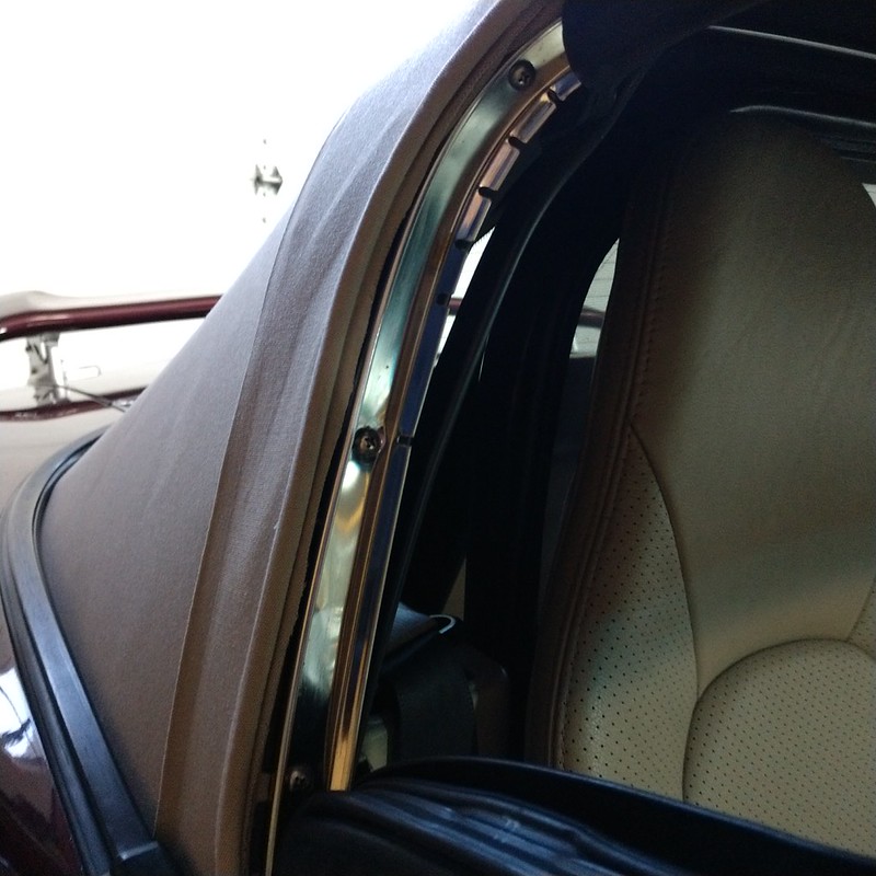

It’s a little hard to see but it was there. Easy enough to adjust if you haven’t before. Simply pull the weatherstrip away from the channel to reveal three screws:
They are in oval holes to provide for adjustment. I loosened all and pulled the bottom as far as I could towards the outside, then tightened the screws. Replace the weatherstrip back in the channel and voila!
