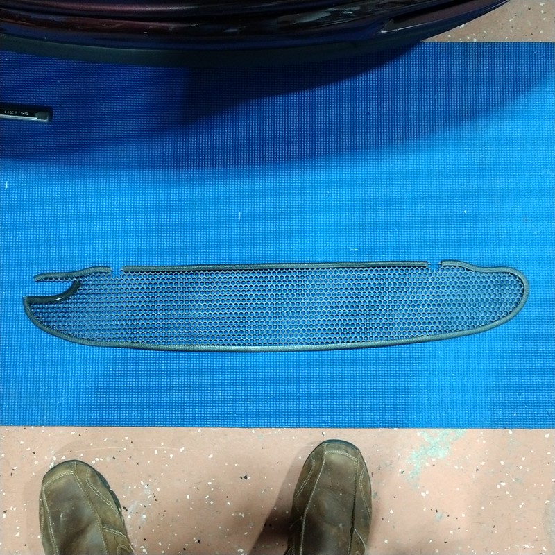

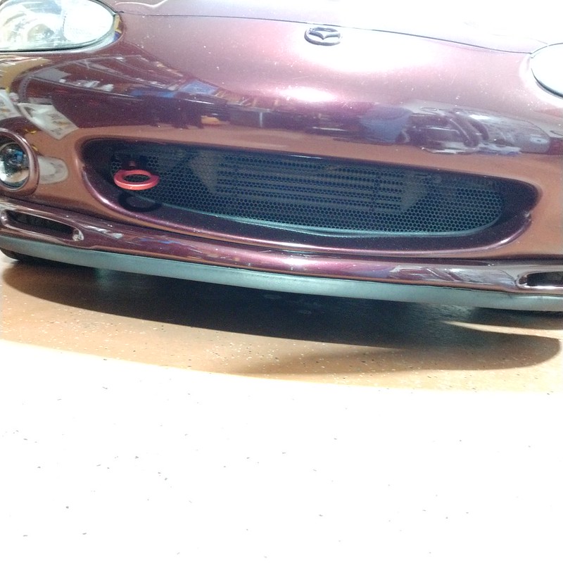

Everything was nicely dry this morning so proceeded with the installation. Yesterday evening I put the edging back on, along with a piece of silicone hose I split to cover the cut-out area for my tow hook. That looked like this:
I ended up taking off the hose piece as there wasn’t enough room for it without cutting the grille back further. I mainly wanted it to prevent any rubbing on the tow hook but clearance looks sufficient for that to not be an issue. First time I put it on the sections for the bolts wouldn’t line up so I removed it and cut those back a little more. Second time was a charm!
As can be seen, it appears almost transparent to the camera so I don’t think it will block too much airflow.

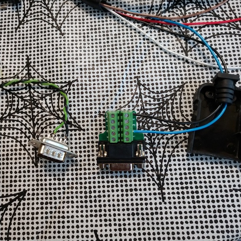

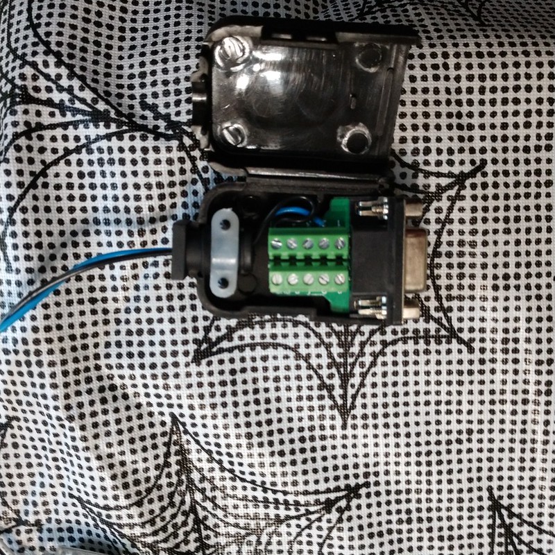

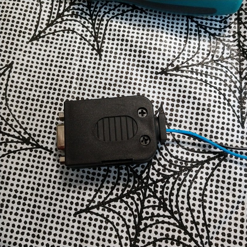

I’m running a bit behind on updating this. Heard back from the MS builder, turns out that the AEM came out about the same time as the CAN module was made. Something he told me was that each piece has a discrete address which must be in the CAN module for it to function. Unfortunately this means that I can’t use the CAN functionality of the AEM wideband. He did say the serial connection was good for the AEM. OK, so I’ll do that. As I like things tidy I decided to source a serial connector to hook the AEM wires up to the serial connector coming out of my MS. Two days after ordering it showed up, and here is what I did:
Once that was all together I connected everything and tried firing her up. I say tried because I was unable to figure out just how to get the MS to recognize the wideband with the connections I made. After some frustration I just went ahead and connected it using the analog wires, and voila! I am going to seek some help with this to see if I can find out how to get the MS to see the wideband using the serial connections.

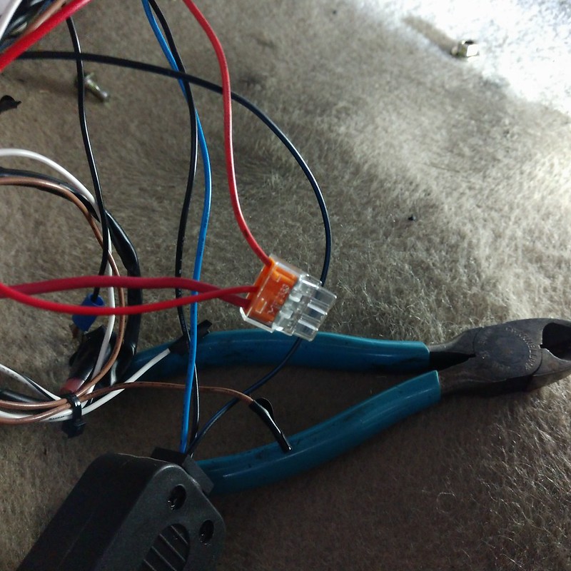

I did use a new piece to connect several power wires. I was unable to find exactly what I was hoping to (something that will enable me to disconnect the power wires easily) but this little gem is working for now:

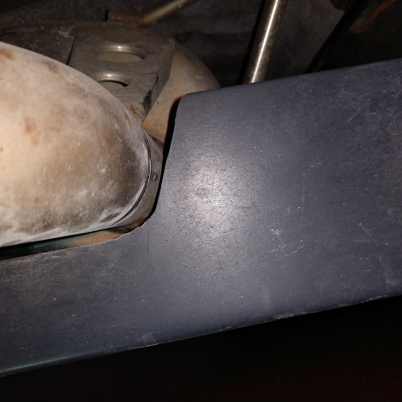

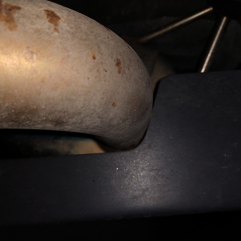

The other thing I noticed was the right-side muffler outlet was contacting the lower diffuser. Not sure how it shifted as the opening is plenty large enough, but here it was:
A little time with some tape, pencil and my Dremel took care of that problem:
I’ll smooth the edge and round it better the next time I remove the diffuser. I suspect I was getting some extra noise transmitted into the cabin due to that contact, but time will tell for sure.

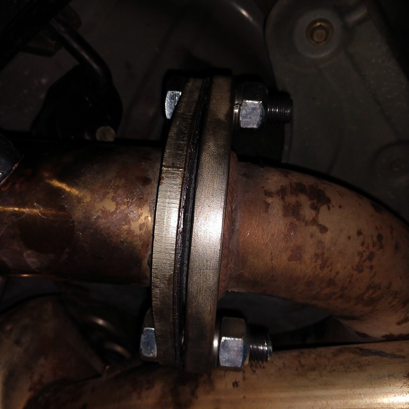

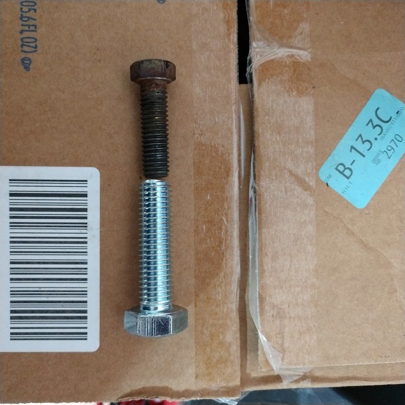

On my way to some babysitting duties last night, she suddenly got louder. I suspected the muffler clamp I had tightened had broken, but when I had a look once things cooled down I discovered that both bolts for the flange connecting the exhaust pipe to the muffler had come loose. One was completely gone, the other just hanging in there. I yanked it out along with the gasket so I could get new ones. This morning I dug around and found the other bolt had dropped into the diffuser along with one nut and lock washer. I took some measurements and went to Ace. The bolt holes were 13.5mm while the bolts were around 10.5mm. I decided to go with a more appropriately-sized bolt and picked up M14s along with some lock washers and metal lock nuts (don’t recall right now what the proper term for those is). When I got back home I was able to wiggle things and get one bolt in but not the other so I used one of the old ones for now. I’m going to have to drop the lower diffuser and the muffler, then hog out the bolt holes a little. This should provide for a more positive joint. I was able to get the old gasket in well enough to seal but will be buying another to do it right. I have no idea what caused the original bolts to lose their nuts, as they had looked good when I was underneath last week.
While I was able to squeeze my hand into the space between the diffuser and muffler to get things back together it was not done without some repercussion, as seen below:
Sometimes I feel like I am almost smart. After some research yesterday for the muffler gasket, I thought I might have posted the last one I used. Sure enough I had a picture so I checked my local O’Reilly’s and they showed it as being in stock. Picked that up yesterday afternoon so I was ready to go this morning. Hoisted her in the air with the QuickJack and set to work. Removed the lower diffuser followed by the muffler. I checked the fitment of the M14 bolts in the flange holes, and found the lower ones were fine while the upper ones showed some dragging. I hogged all four holes out a little with a ½” drill bit until I was satisfied with the freedom of movement. Here you can see the bolts that I was using compared to the new bolts, the larger size will give a proper fitment:
While everything was apart I took a close look at the flanges. The one on the exhaust pipe is flat while the one on the muffler has a recess. However this recess is not consistent in depth due to how Racing Beat welded the flange to the muffler. I decided to try using a flat gasket I had made for a previous use in addition to the round gasket. You can (sort of) see how that turned out here:
A quick leak-check was good. If that comes apart then I may just weld the damn thing up. Oh yeah, and there is now plenty of room on the passenger side of the lower diffuser where the exhaust pipe exits. Had I looked more in depth to that contact problem last week I would have found the muffler bolts were loose. Ah well, then I wouldn't have installed these mondo bolts.
