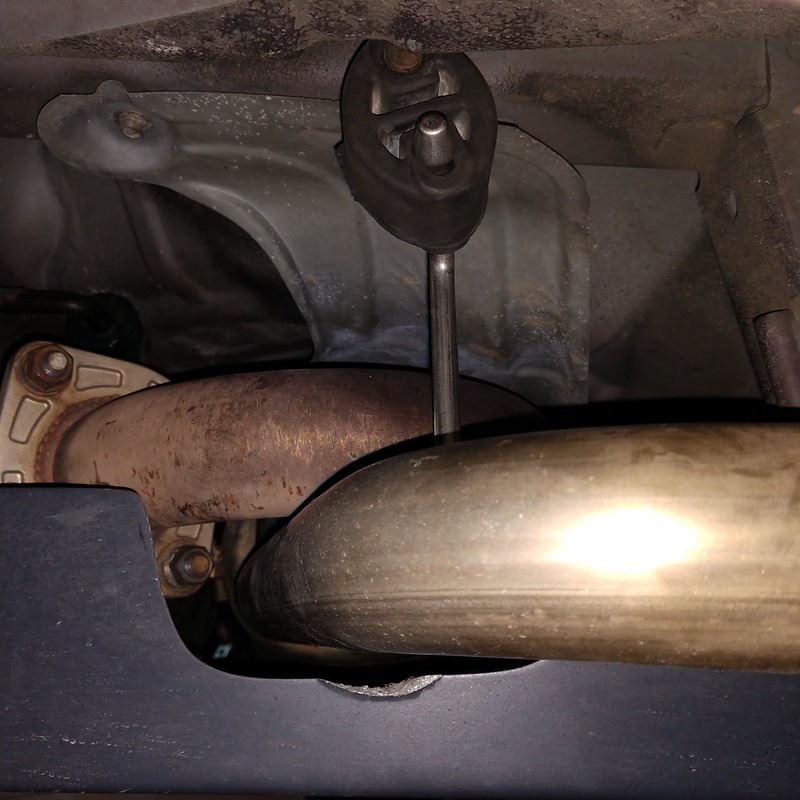

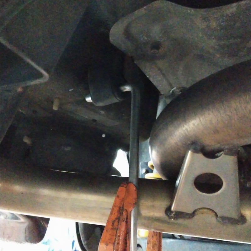

Removed the lower diffuser and my temporary muffler hanger (which had been installed for something like two years). I then set up the new hanger I bought:
I need to buy myself some proper ViseGrip welding pliers to make this easier the next time. I didn't have any stainless stock to practice on and my first attempt (which was vertical) was barely good enough to get it stuck in place. I ended up removing the muffler to do flat welding. Not the best I have ever done but it's solid and only ended up a little off-set:

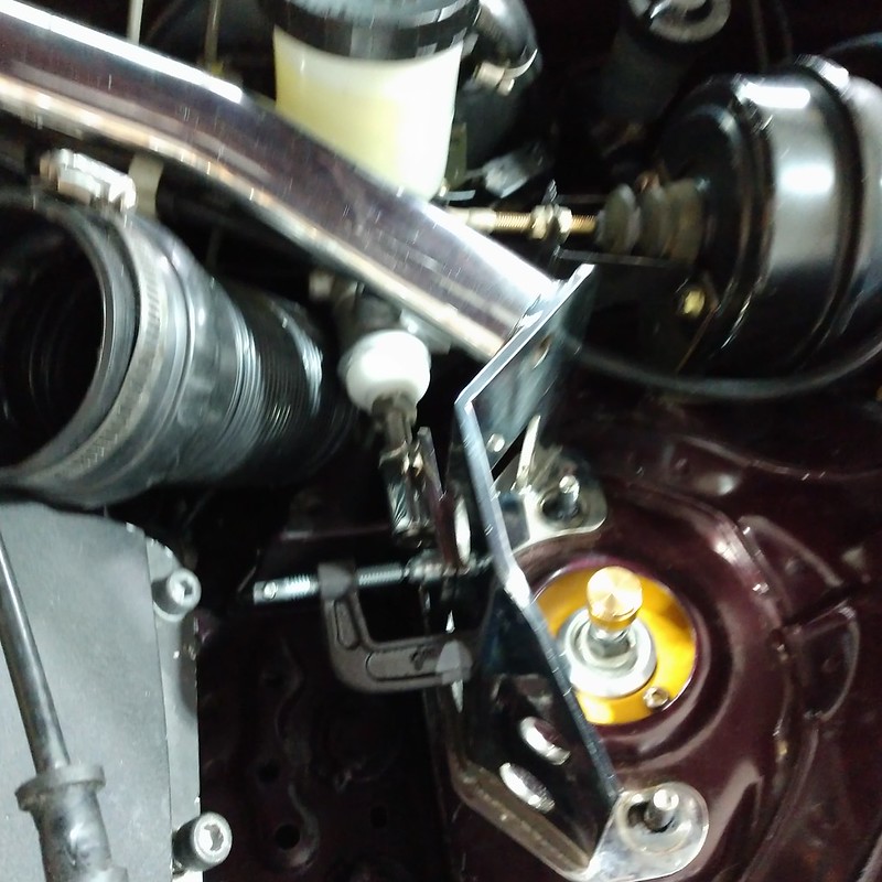

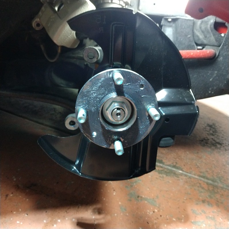

Once that was done I put it all back together. I forgot how much of a PITA a couple of the screws at the back of the diffuser were to get in place. I literally was straining to put the middle one on the passenger side together. If I did any sort of bulk exercise I would have been screwed. In any event it is all back together and as can be seen, the muffler is well clear of the previous impact zone on the diffuser:
