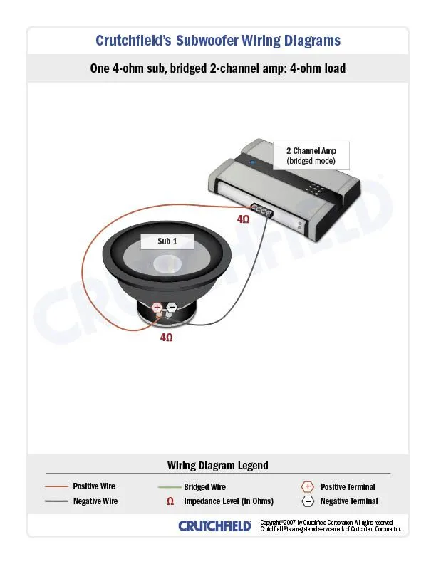

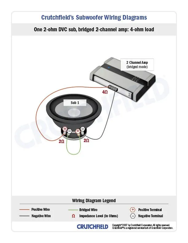

Any benefit to using dvc or svc?
I assume these are the wiring schemes you mean?
No, there is no benefit once you know what wiring scheme you are going to use. DVC and SVC are really just a way for subwoofer manufacturers to reduce the number of versions they have to make.
