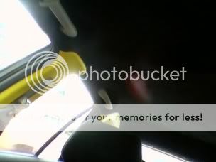

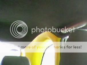

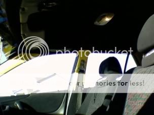

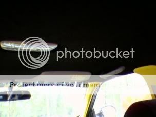

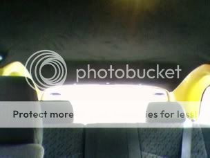

First of all here is the paint I used:
And here is some more pics for you guys/girls:
All you need to know is it looks sweeter than you could ever imagine in person, just read sam1's comment above. He saw it in person. Enjoy!
mazdaspeed777 said:
Yep, "there ya go little fella"
