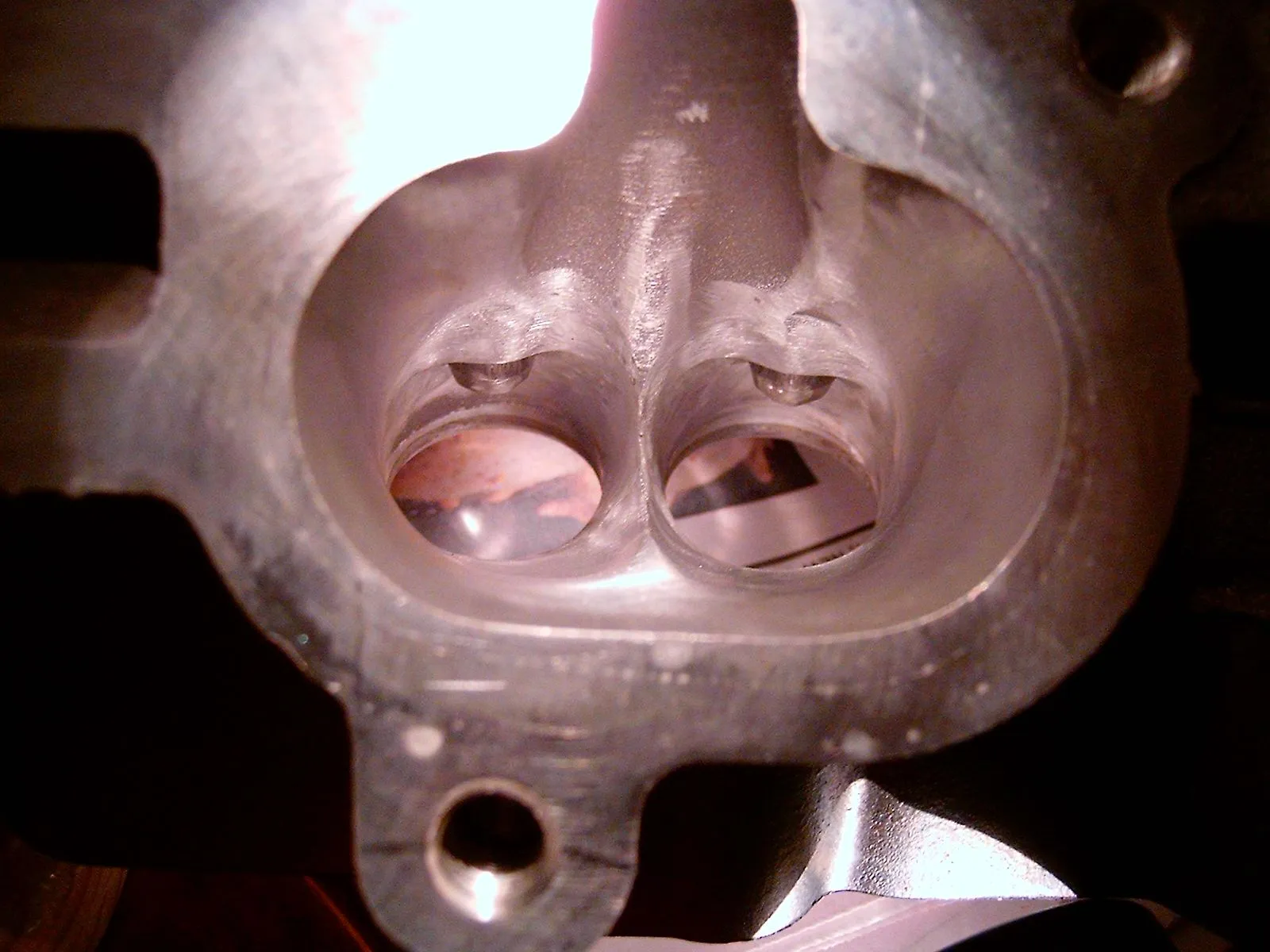

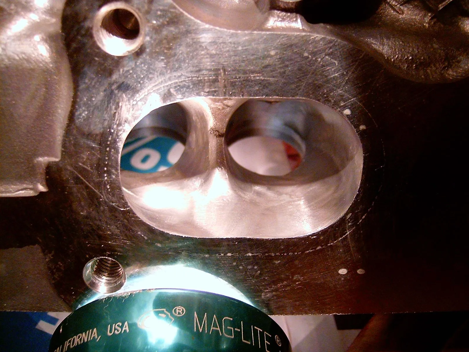

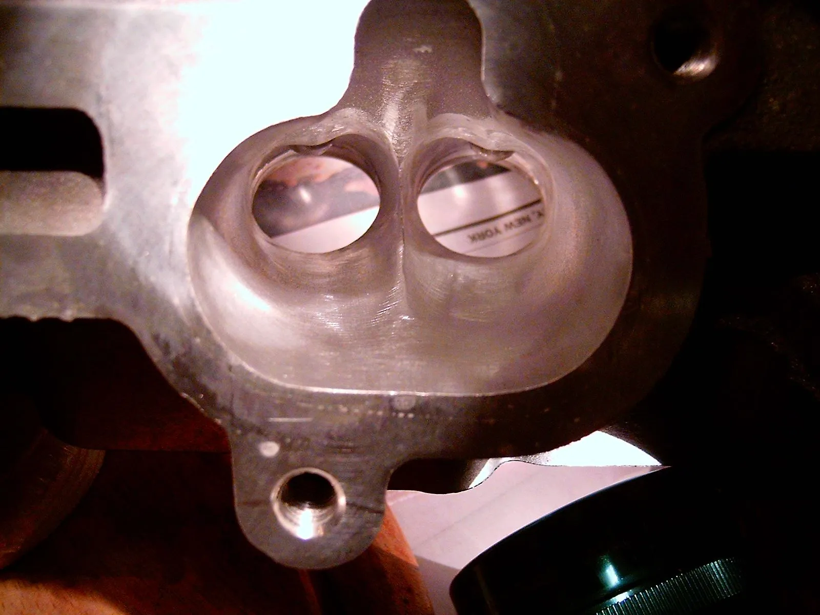

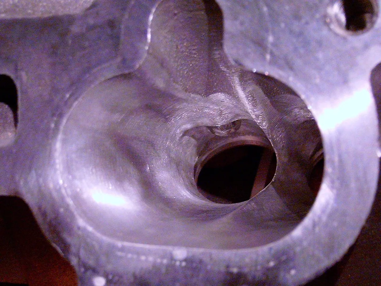

Well I found out how hard it is to take pics. of headwork and make it look good. After discussing the time table with the guy that flowbenches it for me it looks like I will doing all the ports at once then getting it flowed again.
Heres some pics of my progress so far.. yeah the pics suck, I just couldn't get the lighting right.
