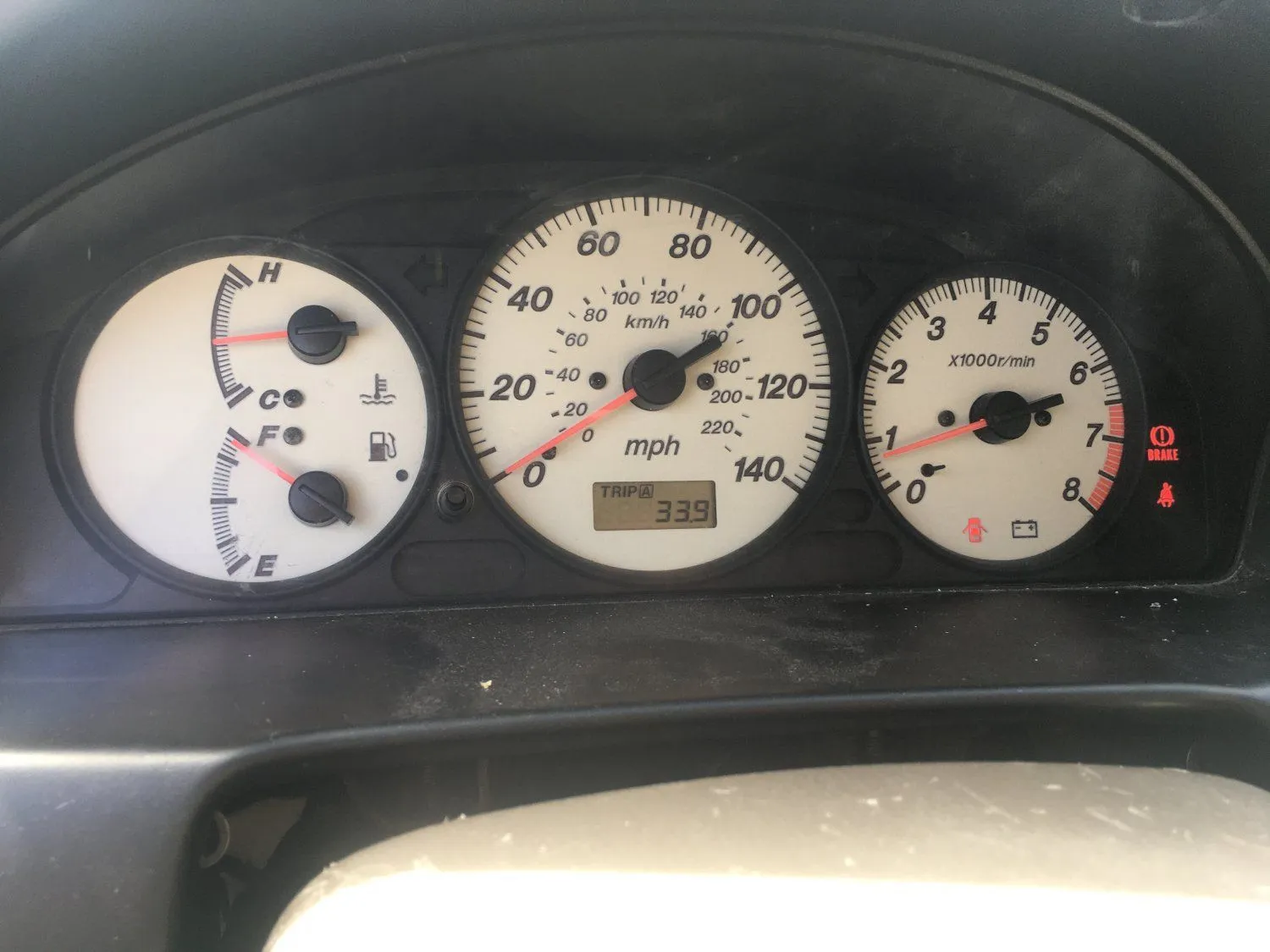

It’s plug and play! I got a nice cluster from a P5, automatic tranny. Everything works- high beam light, turn signals, and tach. I think if you have a Violet/White wire going to your guage cluster on 2001-2003 Protege/Protege5 you can swap these to your hearts desire. I think you have to run your own tach wire On 99-00 Protege DXs. Thanks again.
These white gauges are a lot more visible when you are concentrating on the highway and it’s super nice having a tach 👍.

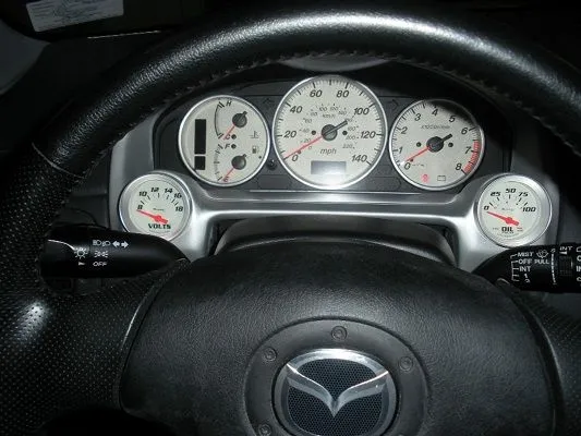

My parts car has the cluster with the fancy chrome rings on the gauges, whatever they're called.
EDIT: It's not the metal rings, ... It's a metal faceplate.
The DaveB rings? My main one does................
surround is charcoal now............
