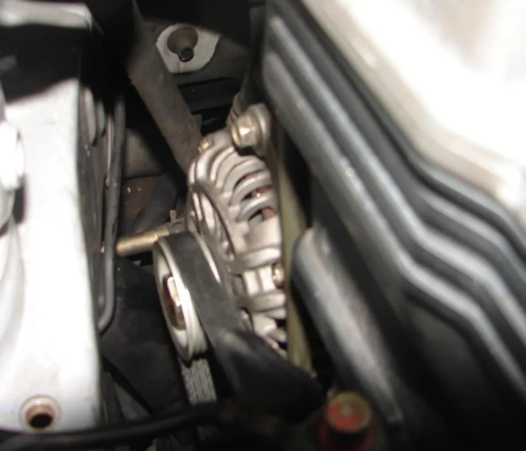

go take a picture of yours real quick and we will see if mine was installed properly as you seem to think it wasn't. Plus you would be able to tell just by looking at the belt if it was installed inproperly.
Edit: Jeg when I get home from work tonight I will take a picutre just for you.

If the pulley was installed backwards the belt woudlnt line up and if someone were to get a belt on. The belt would break or pop off before the pulley would break or thats what i would think anways.
OK, did this happen pressing it on the shaft? Looks like it went on a bit past being flush like oem. Shaft looks to be protruding about an 1/8 or more. Or did this happen while in use? & what happened to your alt pulley? Caught wind of design change but didn't know why it was being changed or that there would be a swap out of any sort.
No, it did not happen when I was pressing it on. I made the how-to several months ago and the pulley just broke recently. I pressed the pulley on a tiny bit (1/16") too far, but I added some thin washers on one side of the pump's mounting brackets to correct that.
I don't get it, someone said the same thing when a dude posted his pics of the belt not lining up properly (on the pulley itself) a few pages back. The grooves in the pulley not matching up with the notches in the belt has nothing to do with how far the pulley is pressed on. (scratch)
Hey 505zoom, when did the pulley break like that? Was it being driven or still being installed? No offense, but it looks like it was possibly installed poorly.
No offense taken. The only problem with my install was that I had to tighten the tensioner down much more than normal because of the above problem. The pulley was tracking straight, wasn't wobbling, and for a few months there was doing it's job just fine. It broke just out of the blue one day while driving.
