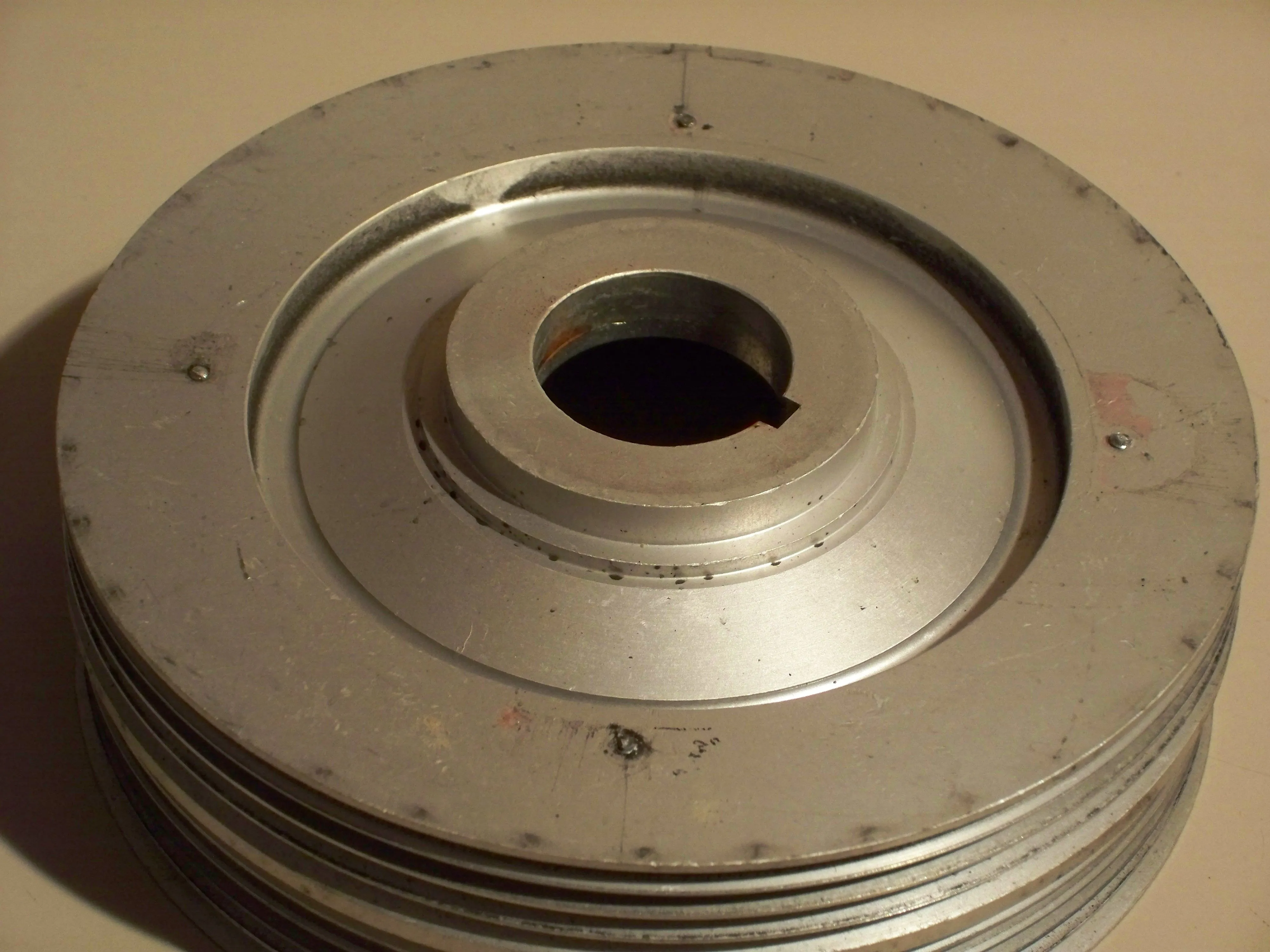

Hello, Brach. I purchased a crank pulley from another member here, and apparently I got the first set of screws (they were a phillips head). As it turns out, I guess they weren't strong enough, because they sheared off. Is there any chance I can get a replacement, or even just replacement screws? I don't have any easy-outs to get these little screws out... Any advice on that? Pic is attached
(Sorry, I didn't take a pic of the back of the pulley before installing- but I do recall that they were phillips head screws, and sat flush with the timing gear.)

I hope the screw problem was fixed with the new screws being shipped out. If there is anyone with the new allen head screws in the pulley and have the pulley installed, please comment and give us an update on how its doing.
have the new screws in the crank pulley for a week now. no problems yet. i just have to tighten my belts some, i get a tiny bit of squeal every now and then when it gets hot enough.
By any chance do you have a torque spec for the screws or you just did it hand tight? Use any locktite?
By the way, I bought the pulley off of S.A.MSP, who according to post 996 of this thread, seemed to be quite in-the-know of this problem:
should i still hold off on the Crank Pulley install? i can lock the skrew up with lock tight, my stock balancer is slightly bent
yes, the screws back out then you'll lose your balancer
That's not the balancer it's the motronic trigger wheel for the CKP sensor...
oops, sorry for the misinformation, thanks for the correction!!
...That's the part that really sucks. Not bashing him- the sale was a nice transaction, but he certainly should have mentioned this issue in his for sale thread... I wonder if he has four screws sitting around...
how many miles did you put on it?
Haven't even gone through an oil change... been several months, but my msp is a garage queen. I would guess about 2k or so.
