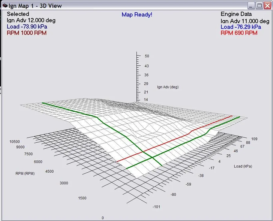

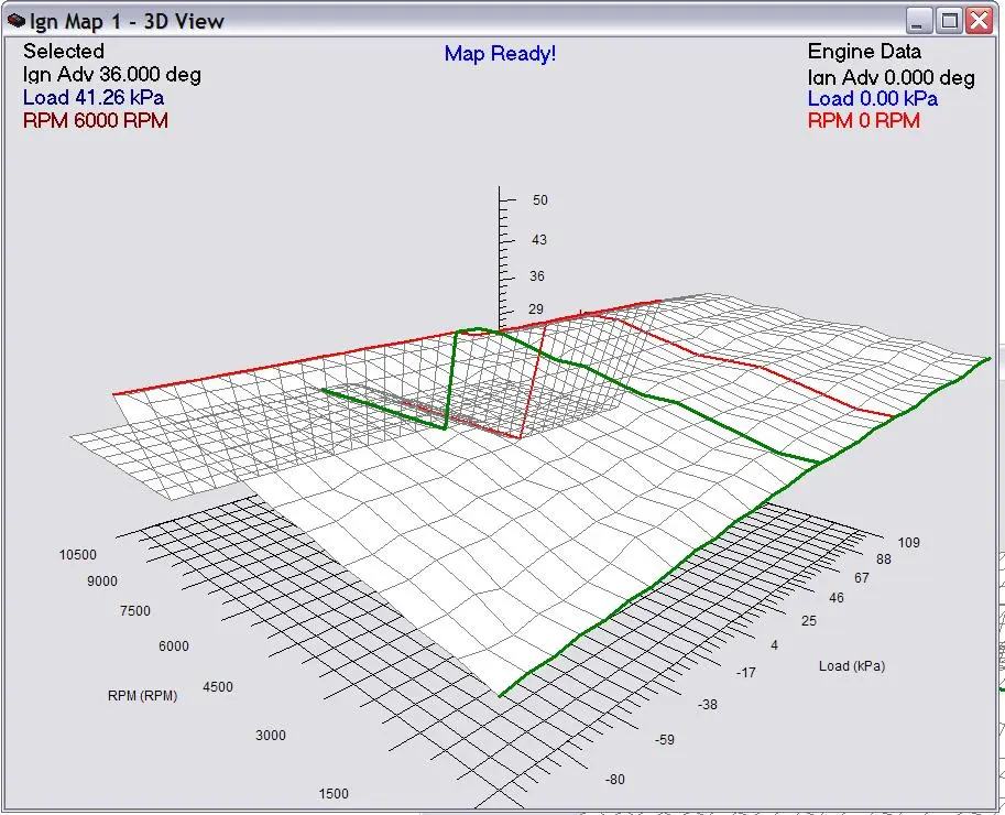

So now my only problem is the high EGTs. Today with the ignition map loaded, I got much better throttle response, but the temps are back up to 800C when cruising, and spike occasionally even higher.
Here's where I bite the ego bullet and say: I have no idea what the ignition advancing and retarding really does. I assume advancing means earlier spark in the combustion process, and retarding is vice versa. What I don't know is what the benefits of either direction are. The only way I knew to get this ignition map to where it is was my quick and dirty analysis of a couple other maps people posted (Linuxracr, pdhaudio, etc). But they all run the larger 440cc injectors that I don't have.
So, with that said, I want to get my EGTs down, first, so I can reliably drive to work and back without cooking the whole thing. What's the best way to do that?

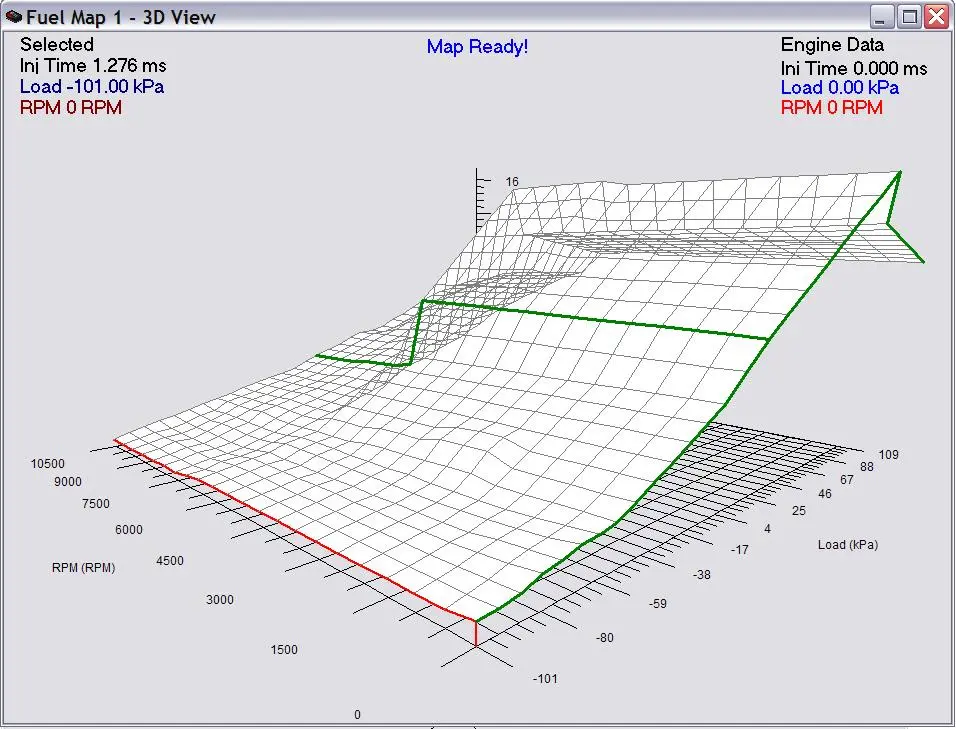

One other note. Even with the high temps, I am getting 13.5 or so AFR when I am on the gas. Obviously a little more work to get it higher. Though I just researched online, and found that I am a schmuck. I was tuning to get around 12, I need to get to 14.7. Oops. That's what I get for not doing my research to doublecheck... Welp, that should be easy enough to fix. I am idling around 12, and most of the tuning I have been shooting for 12, hence the high temps?
Current maps: You'll see I fiddled with the ignition map a little today trying to see what would happen. I didn't mess with the fuel map at all today. This is before messing around to get the ideal 14.7.
