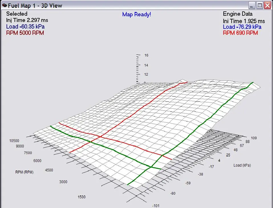

Here is a shot of my fuel map. I haven't done any timing adjustment yet. This is the standard ignition map pre-loaded with the .

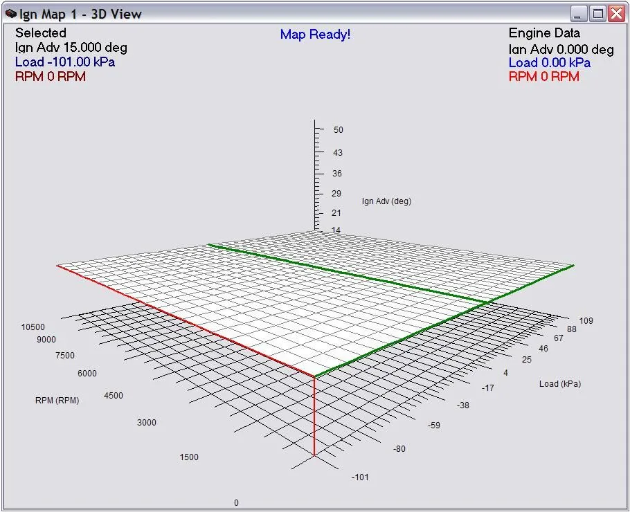

Oh, I can definitely use some help on the ignition timing. I am not sure what exactly my goals are there, nor what benchmarks I use to determine whether my timing adjustments are effective.
I have been tuning the fuel maps with the goal of 12.0 AFR on my PLX m-300.
