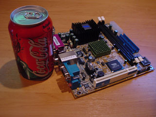

Those of you who want to do their own in-car-computer project, here's your starting point...
http://www.mini-itx.com/
It is a motherboard sizing in at 6.75" by 6.75" that uses a 1.6GHz Pentium M.
Got it.. love it.. I have the EPIA M10000 1Ghz mobo. I dont need anything more because I mainly only play MP3's and DVD's.

Just sharing my research. I am pre-planning my carputer setup. I have been building computers since high school and will probably look into one of these as a barebone, or quite possibly a similiar shell. The footprint is exactly what I am looking for, and in these (they come in quite a variety) you can stuff a P4 if you wanna. Prices for a Full system are still kinda high, but you're paying for the size in this case.
It's dimesinos are 6.18" x 5.75" x 2.2"

I'd stay away from P4s they get pretty hot. If this is something that will go in a glove box or under the seat, you will definatly need some kind of active cooling. (Maybe redirection the floor vent under the seat to blow through the case.
That case looks really sweet.
HP have some small work stations, and since puters are meant to have fairly low working voltages i'm sure it would be no prob to just didtch the inverter and run it that way.. these workstations are a bit bigger than a single din radio, and as for cooling i guess there are several options, re route a duct, except when the heater is on, it will cook... pack it in ice, but lets face it thats silly...
