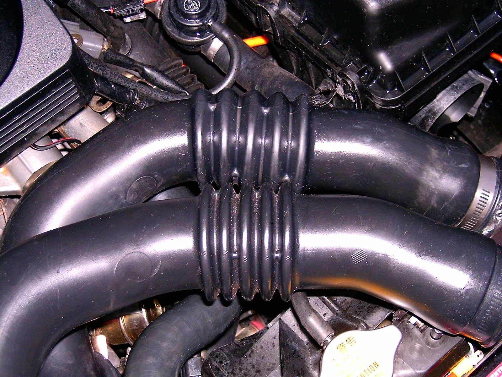

Here you can see my poor, poor intercooler pipes when compared to a regular sized one.

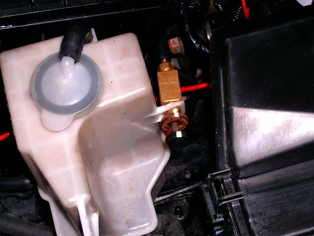

Also the extra injector set-up.

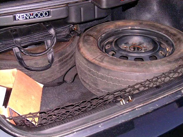

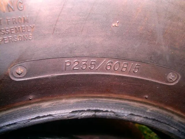

The tire combination I will be using this year.

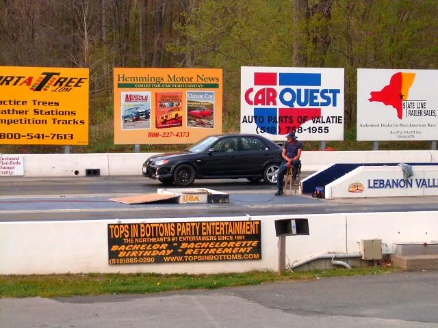

Here's a pic of the car last week at the track.
And a pic. of my launch testing area. Needless to say that alignment set-up didn't work out as well as planned. (Yes I am launching in second gear again.)

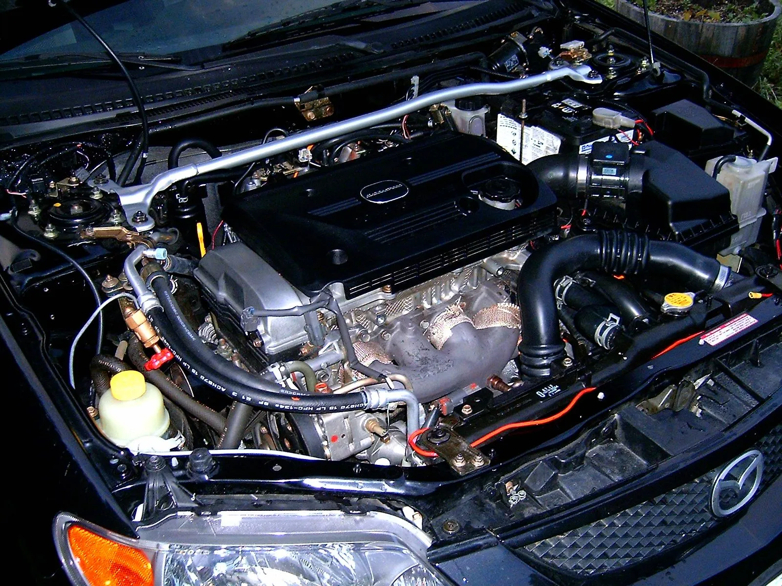

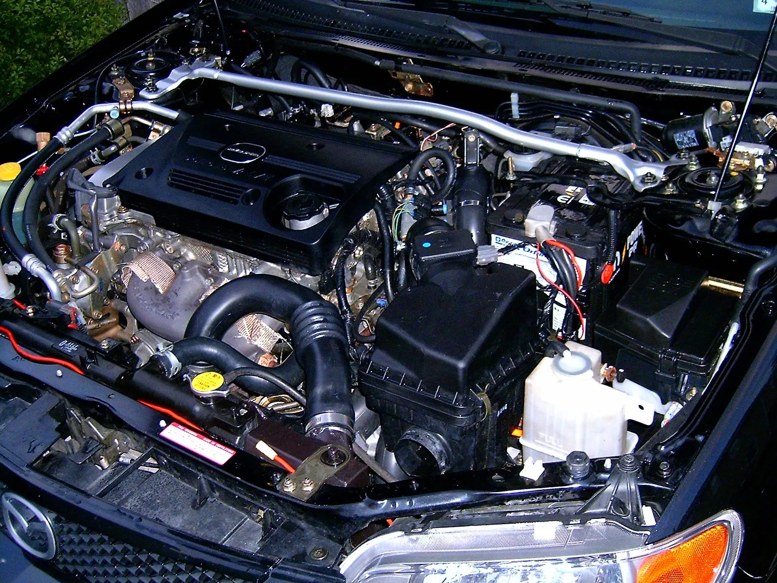

What did you put on your exhaust manifold. Looks pretty nice compared to the rusty look. Did you spray some high temp. paint or something? I like it a lot. I like the work you've done too. Keep it a sleeper..hehe. Good luck on your next runs too.
Thats Eastwoods high temp coating (1800*) cast iron gray. It works very well, however the header wrap kinda rubbed it off in a couple of places. The header wrap is going back on, I had to take it off to put the other wastegate on. This time the stock heatshield is going over it for a even more stockish apperance lol.
It will hit 12's, wether it be this week or the next, or the next, etc. If I have to put it on the bottle or put a SRI on or a FMIC..etc. It will get there.
Thats the factory turbo w. MPI's stage 1 done to it and my finishing polishing. The intercooler is a Custommsp's SMIC that I bondo'd and painted to look like the stock SMIC.

13.52 @ 108.69 @ 15psi. Street Tires!!!! 3/4 tank of gas, 2 DOT slicks in the trunk, 2972 race weight with me in it.

Yeah I got rid of those orange hoses.
