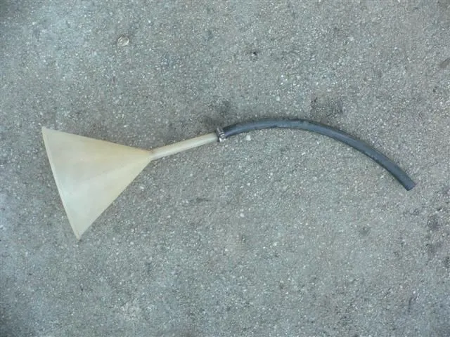

You need something, there isn't clearance for a bottle. I used a funnel and a piece of tubing to fill from above. A pump will work too.

Just to clarify this is a manual. It does not need a flush it needs a drain and a fill just like your engine oil. There are two plugs one lower one for draining and a higher one for filling. It is a very easy thing to do on your own. If you have the tools to change your own engine oil then you have most of the things needed to drain your tranny oil. You will need a funnel and some tubing that fits the funnel like the guy above said.
shoot over to your local parts store . they should have a tool that you can actually thread to the fluid container. and they should be cheap. just ask for it. much easier, just be aware of fill levels. On the Dodge I think it was like 3/16ths below fill plug. how do you measure that? I could barely get my pinky in at some crazy angle. You can do it for sure.
