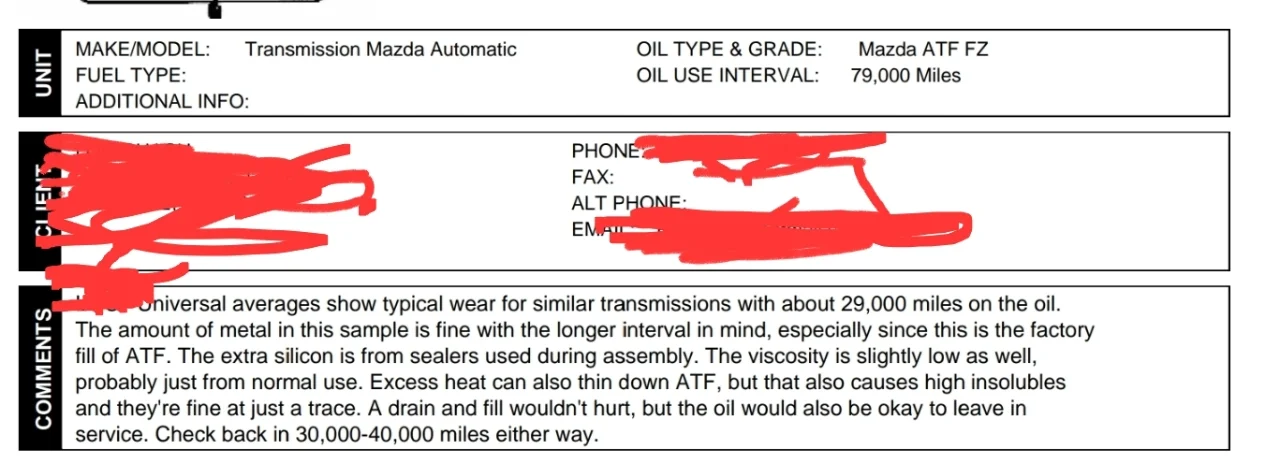

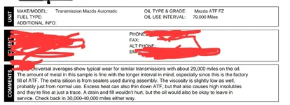

Did a oil test on my cx 5 at 80k. They say it's would be good for 30-40k more. So I guess Mazda "Lifetime" atf is good stuff. I used that data and did my cx 9 at 100k. Thinking my next one would be at 170k? Then we see how much longer car last.
