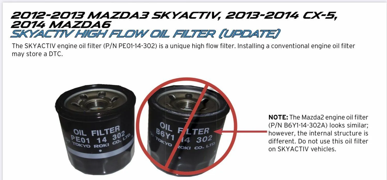

I have a 2020 CX-5 and performed the first oil change on it about a week ago. I'm no novice when it comes to changing my own oil. However, I have never run into this issue. I used Mobil 1 0-20 full synthetic and used a Mobil 1 oil filter. I did the cross reference on the oem filter to make sure it was the correct one. About a day later, my low oil pressure light came on. I checked the dipstick and the engine is not low at all. I also pulled the access cover off and looked around to make sure it wasn't leaking at the plug or the filter and everything is dry. Any thoughts on what the issue might be?
.. Any thoughts on what the issue might be?
Is your 2020 CX-5 turbo or no?
IF Turbo - Mobile 1 oil filter lied to you it is not the same spec as OEM.
For the turbo you need one of the following:
PY8W-14-302 (Japan made most likely you wont find this one)
1WPY-14-302 ( Thai made Denso )
Mobil 1 oil filer (or many other after-market oil filters) is “one-size-fit-all“, and listed to be used on SkyActiv-G 2.0L / 2.5L、2.5T、and older 1.5L used in Mazda2, whereas Mazda has 3 different OEM oil filters with different specs for these engines.
I assume you have a 2.5L non-turbo in your 2020 CX-5. If you check the Mobil 1 website, it says to use Mobil 1™ Extended Performance Oil Filter M1-108A for CX-5 2.5L, but nothing available for CX-5 2.5T. But strangely lt says to use the same M1-108A for CX-9 which has the same 2.5T! M1-108A is said to fit many other different vehicles too. I wouldn’t use those “one-size-fit-all” after-market oil filters just to save a couple of bucks.
There’re some reports here that they have had DTC’s because they used aftermarket oil filter, and swore they would use OEM filter exclusively on their CX-5. Your problem could be related to something else. If you have 2.5T you‘ve used wrong viscosity (should be 5W-30). You can take a picture of the warning message and take your CX-5 to your Mazda dealer for warranty service.
Skyactiv Oil Filters
Here is one MNAO PDF to their US Mazda Dealers concerning genuine Oil Filter(s) installation and use for ALL SA Engines..
Mazda Dealers (in USA particularly) are also seeing stored DTC's (Diagnostic Trouble Codes in PCM) when they use even 'other' genuine Mazda oil filters in Skyactiv engines, see pic, they look identical, but it is what is inside.
You used the wrong oil filter. It may have collapsed internally and restricts the oil flow.
