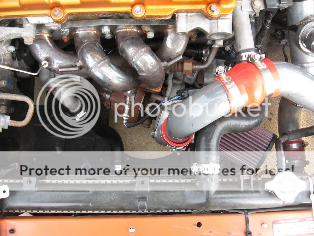

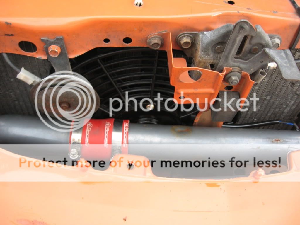

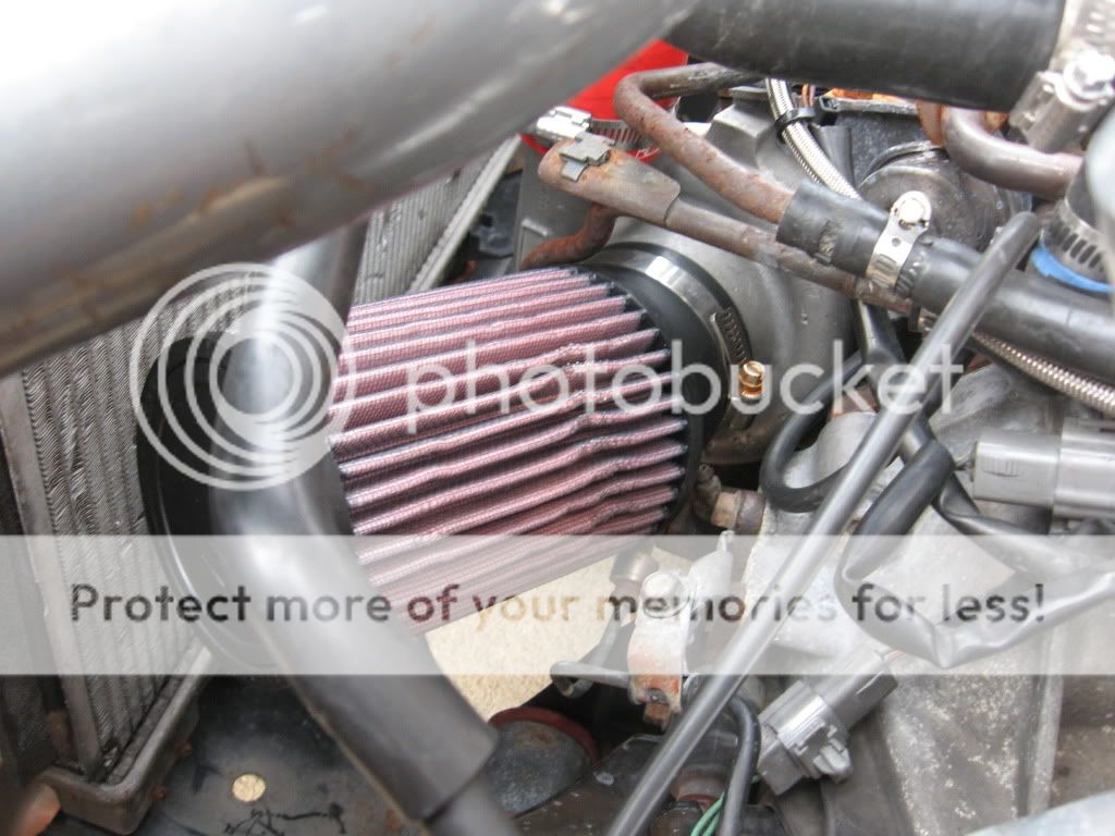

changed a few things up with in this past week
installed a slim fan finally and finally got a filter only intake setup.

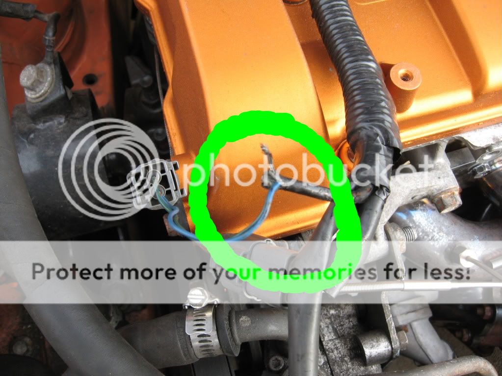

also though i was looking at my wiring and thinking of doing a small wire tuck and i noticed this extra wire coming off my cam position wires. Not sure what it is. Could it be a ground that broke?

ouch!!! that is definitely a problem.
btw be careful when boosting in the rain. it tends to **** up my maf from time to time as water vapor makes it into the engine :(
ya i have no clue what that wire is
but thanks for the heads up with the water, i do have one of those pre filters that im going to keep in the car.
Keith put it on his FC and he lost 2psi so that y im not going to keep it on, just have it at hand for when it rains
so i took off 3/4 of my apexiR1 exhaust and WOW, def. can tell i lost some low end, but the spool up and the punch is worth it.
once i get my O2 sensor and cam potion sensor in ill be doing some street tuning and heading to the dyno.
should have a vid of it tonight or tom.
