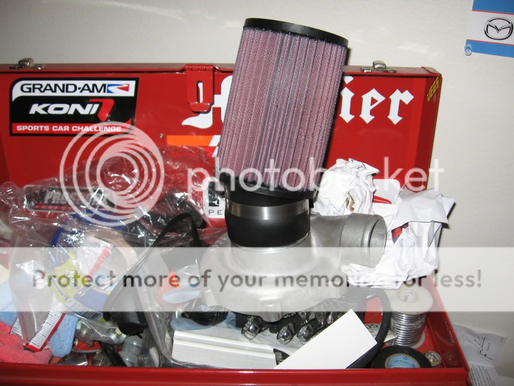

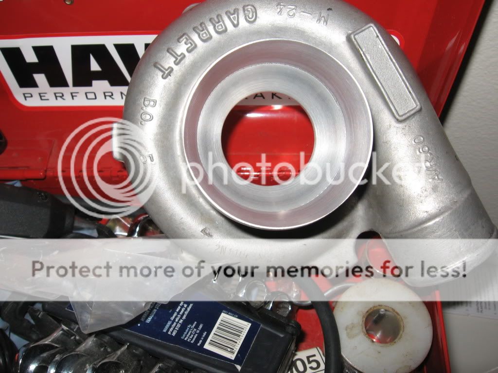

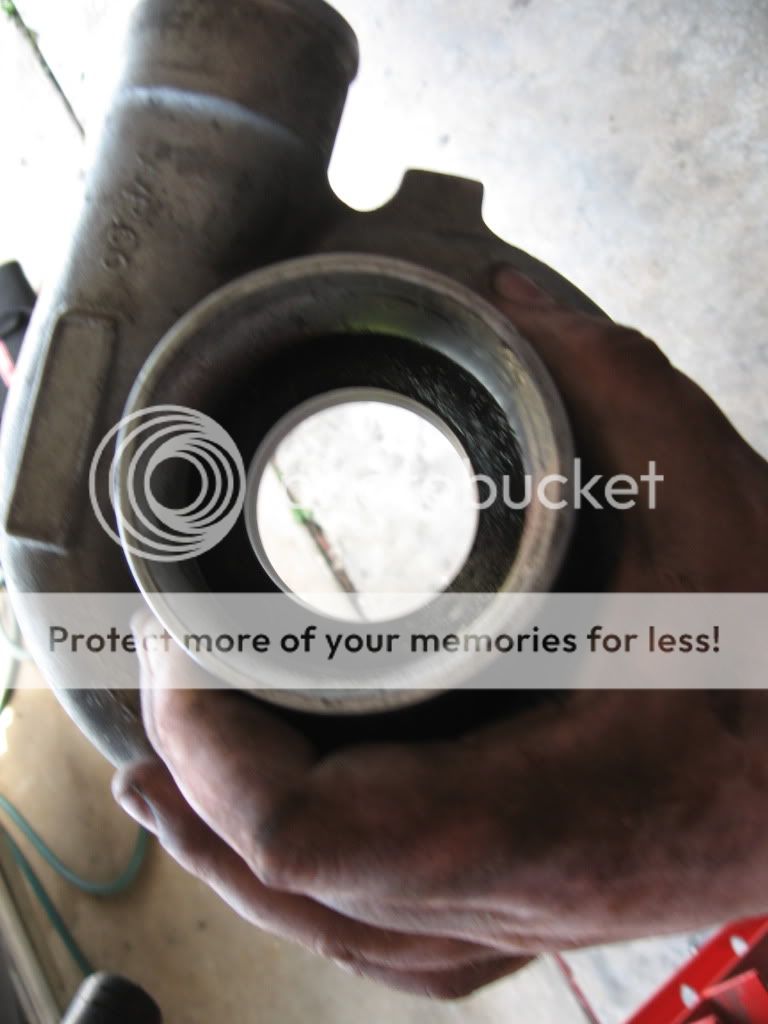

Filter came in and cleaned out my compressor housing and had sen2two open up the GT28RS inlet. Turned out badass, cant wait to get it back on the car.
what it looked like when i first took it off the car
What it looks like after the Ktec compressor housing mod
Then a quick shot of the filter i just picked up.
next thing on the list to do to my turbo before it all gets put back together is to get the compressor housing and turbine housing ceramic coated. With the combo of that, new intake setup, Ktec turbo mani and the compressor housing mod..... Im hoping to have spool up like i used to have when i had the GT25 maybe even faster too
for those of you interested in the compressor housing mod here is the link to his thread, where you can post up questions and add your name to the list.
http://www.mazdas247.com/forum/showthread.php?t=123773863
