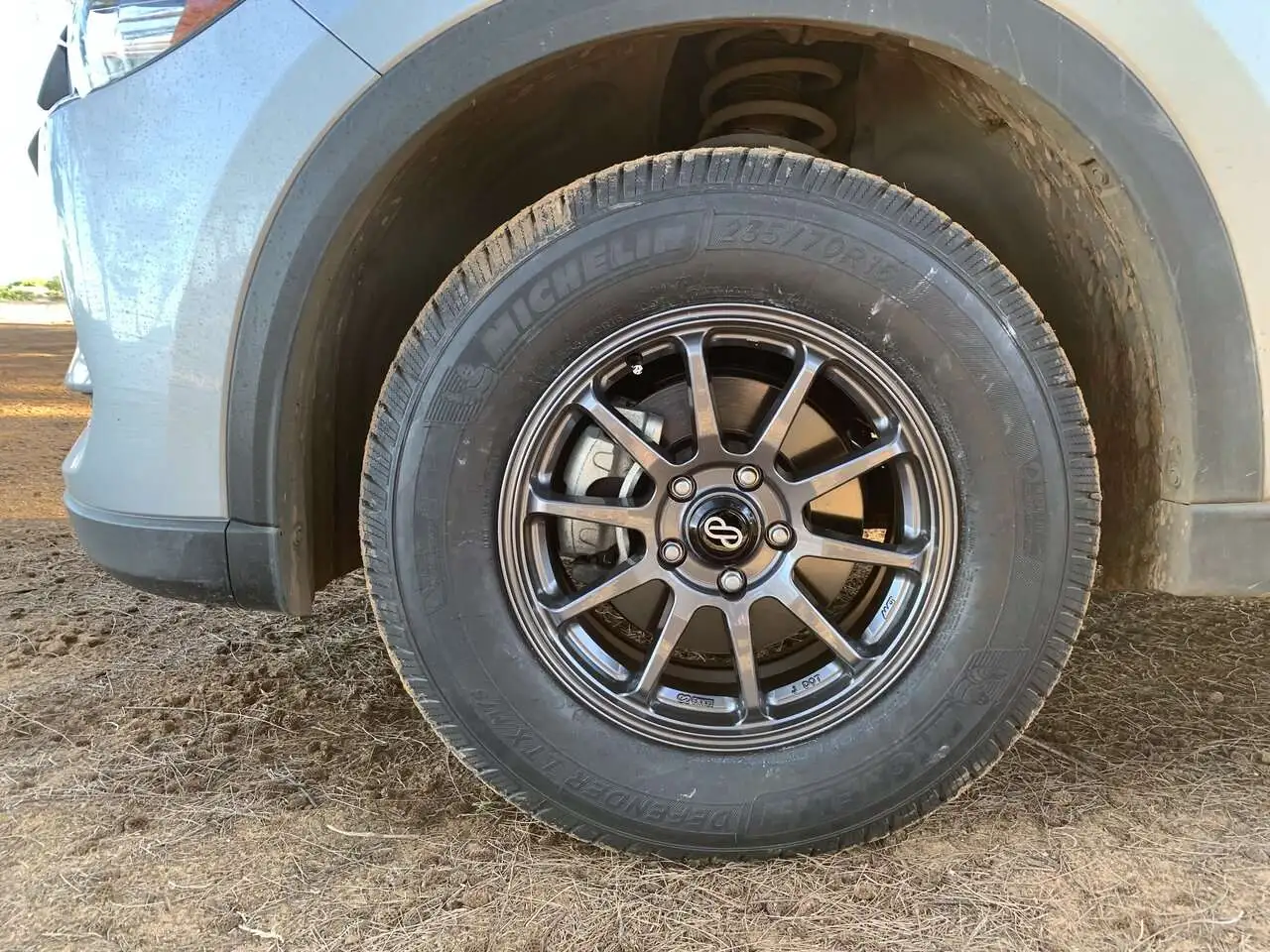

I first tried 235/70/16 Michelin Defender LTX, but it didn't improve the ride (about the same) and it's actually louder than the 17s! This is an "XL" tire (Extra Load) with a load index of 109 (2,271lbs per tire), compared to 100 (1,764lb per tire) for the originals. Tread depth is 12/32nds. I wanted to try a heavier, stronger tire at lower pressure, but this tire proved to be too stiff - even at 27PSI it transmits too much noise into the cabin.
The other thing that surprised me is how much heavier the steering became. I like the light electric power steering of the CX-5 as it comes from the factory and it isn't user adjustable, so this was another issue with the Michelins. I don't know how much of this is due to the heavier construction of the tire and how much is due to the extra 10mm of width. Also, the size wasn't enough of an increase over the standard tire. So I returned them.

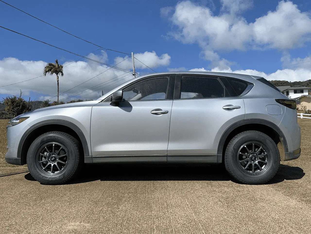

The size I should have got to begin with is 225/75/16, or 29.3". A search of this size on Amazon led me to the Hankook Dynapro HT RH12, the first Korean tire brand I've tried. The tires are made in a U.S. plant. Tread depth is 13/32nds. The Hankooks are much better priced vs the Michelins ($111 vs $198 at time of purchase) and had great reviews on Amazon and TireRack, so I went with them. On TireRack, you can sort reviews to only show people who've reported higher amounts of mileage with a set of tires to get an idea of how they might hold up over longer mileage. Both tires have pretty good reviews, but as I mentioned the Michelins were just too heavy of a tire for this vehicle.
These tires are great so far, quiet and smooth which was my goal with this setup. No rubbing at full lock. This is the largest tire you can get in 16" without going wider. It's good for an additional 22.5mm of sidewall (225 x .65 = 146.25mm, 225 x .75 = 168.75mm) over stock, or .9".

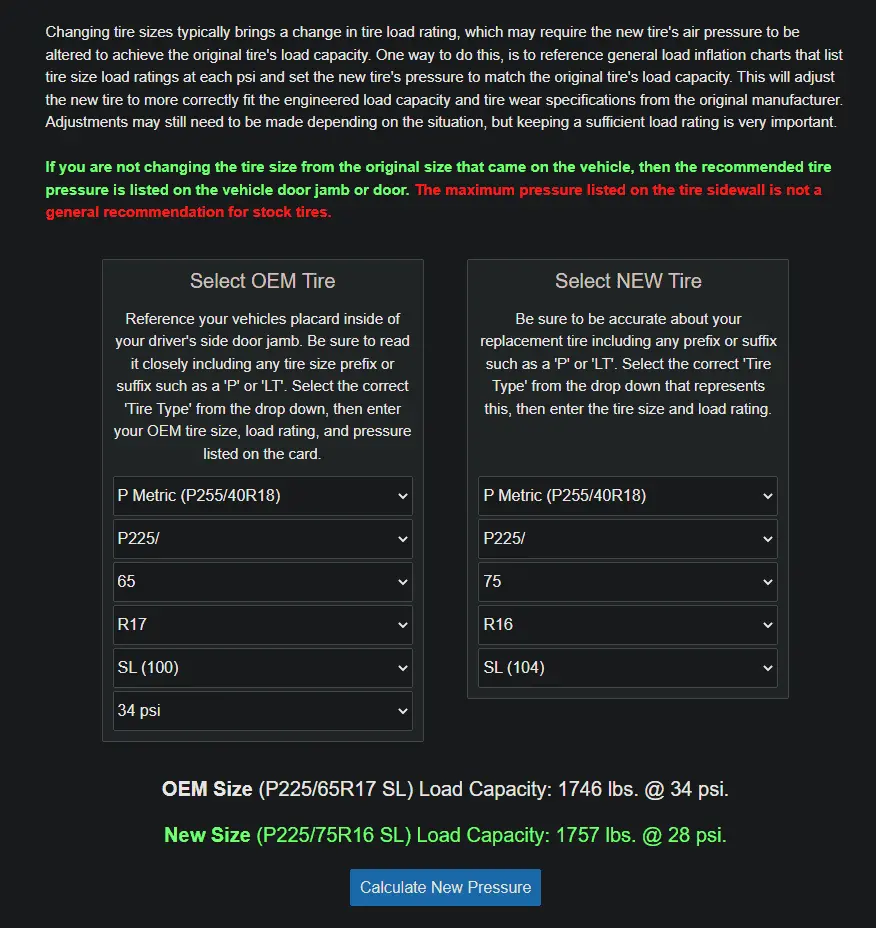

For bigger tires. There is limited room in the front wheel wells, so you have to downsize the wheel to maximize the tire. The wheels are lighter at 16.4lbs each, but the goal is the smoothest, quietest ride and ability to go over potholes and bad roads without concern. These are better than the original 225/65/17 at that. They can be run at lower pressure than a 17" wheel, and the extra cm of ground clearance is subtle but nice to have.

I stayed with the same offset so as not to require an alignment. The car sits higher but there isn't any unusual pulling or anything like that, still tracks straight. Handling is the same at normal road speeds, don't track the car. The contact patch is larger but the tread is the same 225 width, not narrower. There was a noticeable change in handling (heavier steering) with the wider, heavier 109 load range tires, but these tires maintain the original steering response while being smoother (less vibration) and quieter than stock.
The answer is in the first post: Larger tire, more ground clearance, better ride, lower noise, lighter steering and better efficiency. The P225/75/16 tire reduces unsprung weight by 3 lbs from the 235/70/16s. You can also run substantially lower pressure, 28 PSI for P225/75/16 vs 31 PSI for 235/70/16 vs 34 PSI for stock P225/65/17.

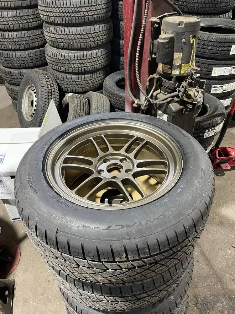

Rpf1 - 17lbs a wheel
Dws06 255/55r18 30lbs a tire
Didn’t weigh the factory setup but just by swapping them out I’d say an easy 10lb difference

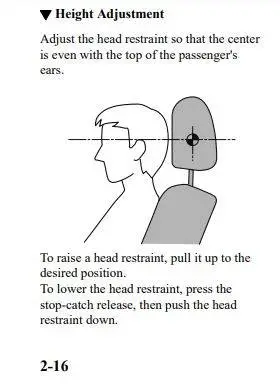

Have you tried adjusting the headrests yet? Despite the commonly used name, you aren't supposed to rest your head on them. In the proper seating position, your head should not be in contact with the headrest at any time.
