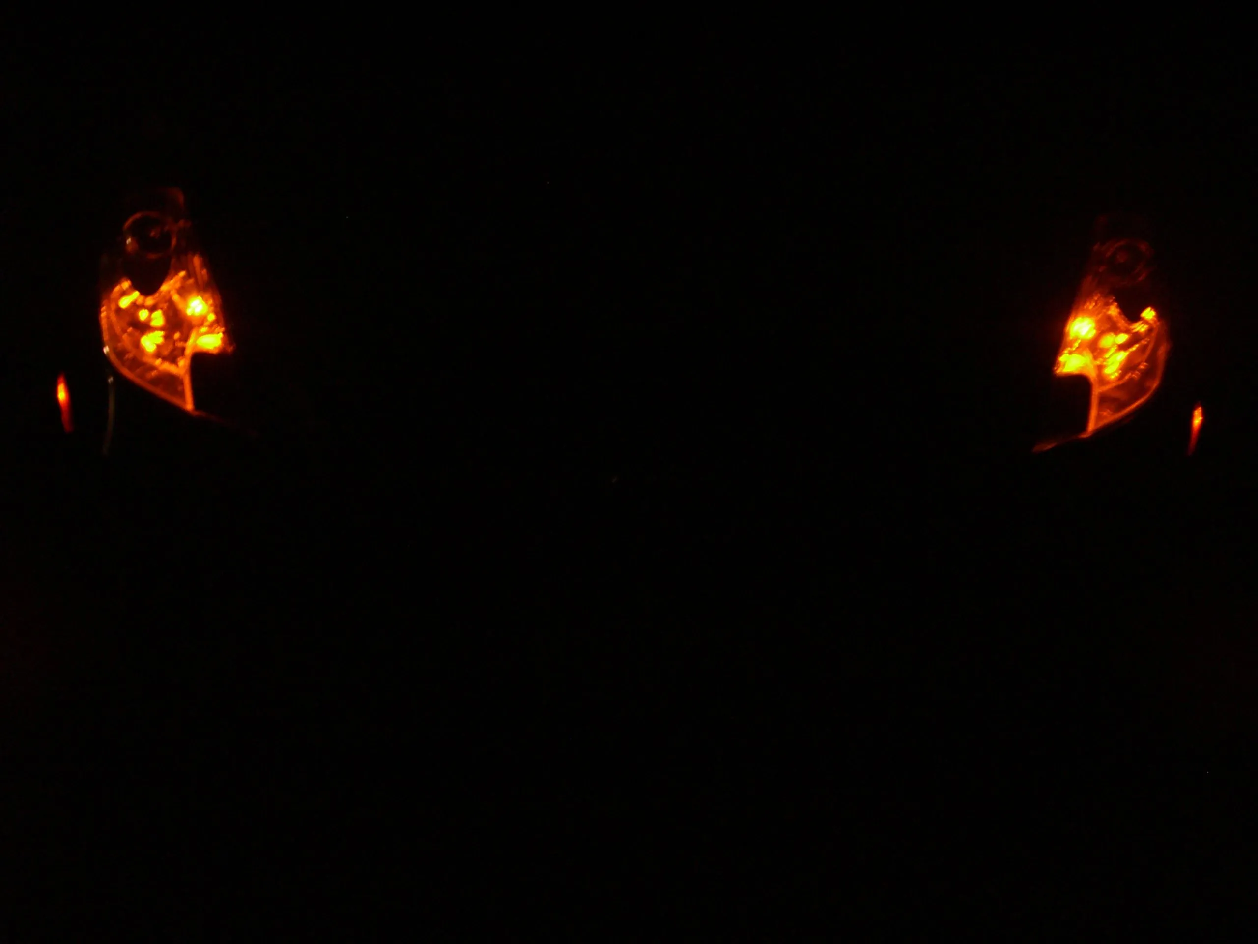

I ordered the tower III in amber (eyeballs) ... hope it turnes out well! Ill post pics when i get the tag and front 194 done!

yeah they are to wide... na man its not your fault you were just posting about the tower II i took the risk on the IIIs. dont know what the deal it with them saying they are the right size. But i put the III in my chicks celica so it ok! I ordered the tower II amber last night!

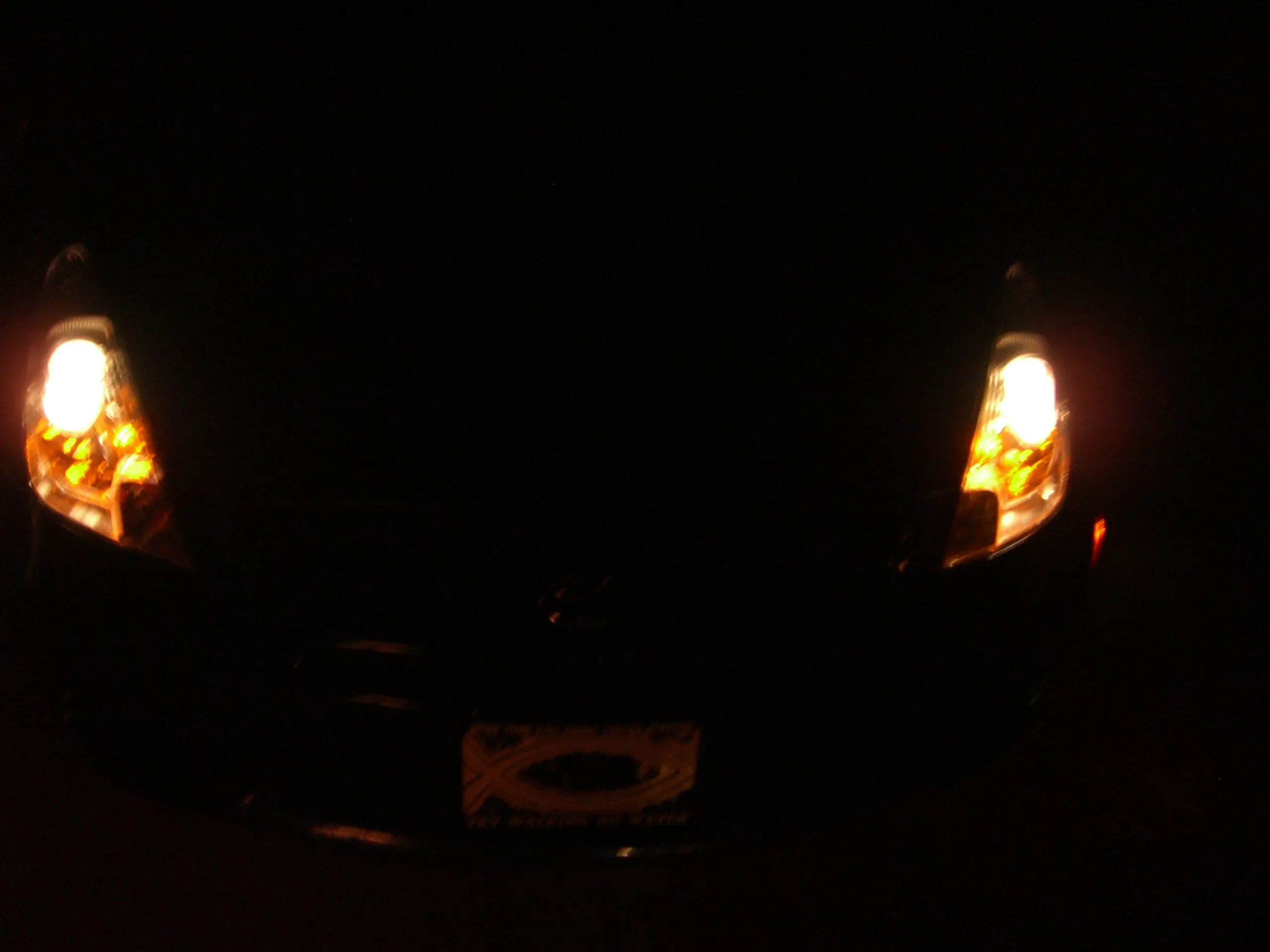

Got pics of the III in the celica and pics of the interior lights but i have a sucky camera nothing good showed up all you can see are the lights in the housing! Guess black lights dont show up on cameras?

Ok just installed tower II amber for the parking lights and frosted for the liscence plate and they look good. They did mess up the order where I ordered 2 reds for the rear dome lights. I just got one red :(
Ill take pics hopefully tomarrow night and post them up.

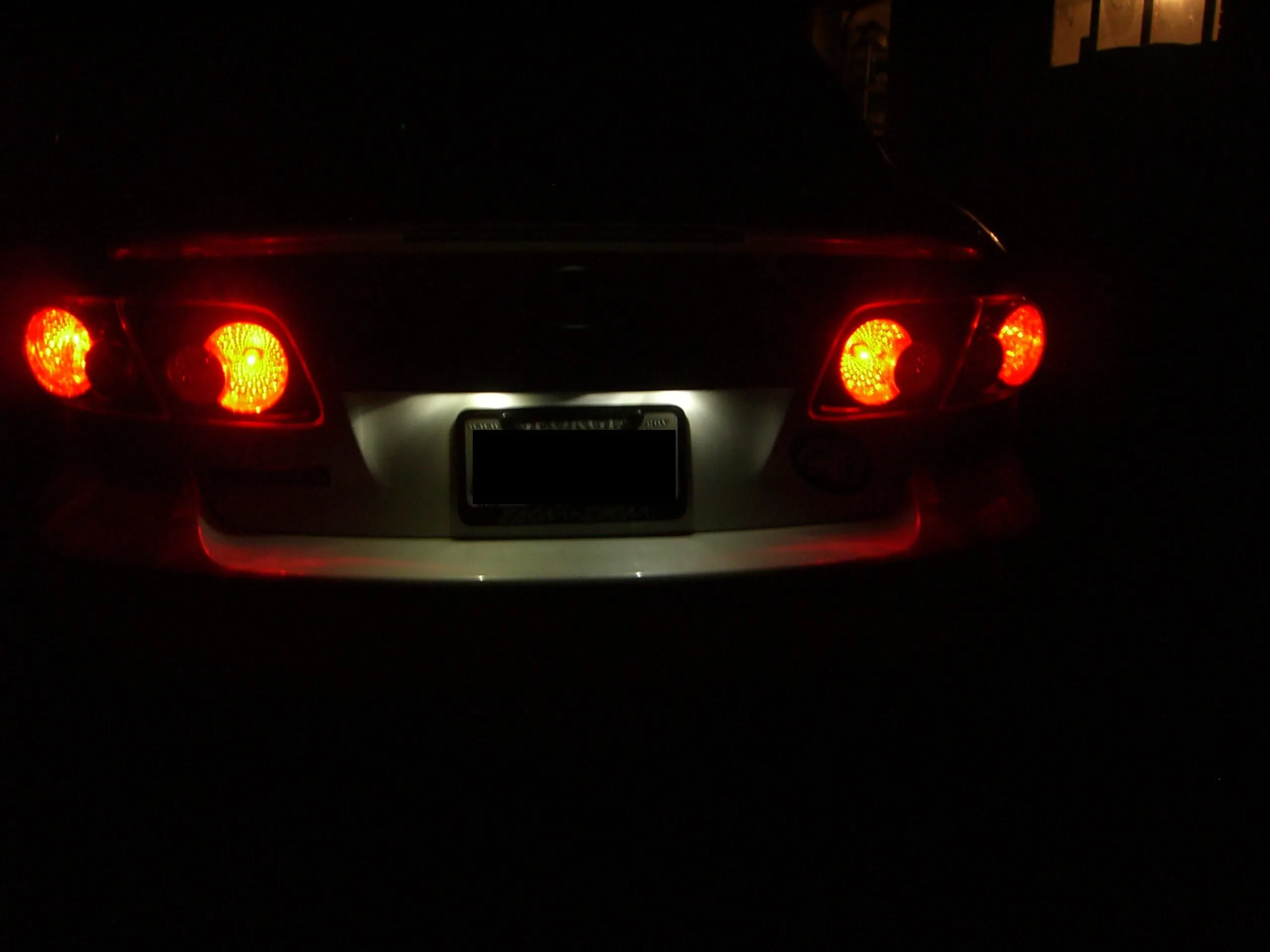

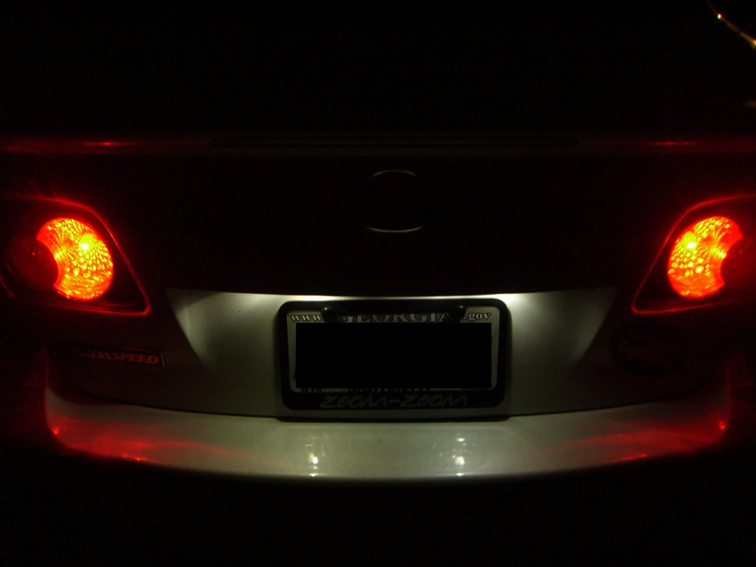

Tag lights, remember my camera sucks and picture taking is not my strong piont!

Speed6 dude, those look great, which bulb did you end up using again? I might change mine, because they're a little bluish. Did you get the warm white?

The WLEDx5 bulb... no it was cool white! Still a real white color not alot of blue. I did not want alot of blue love the white!

I really like how they look. I might have to swap mine now. :( I think I have one W5 still from my testing order, I'll change them around this weekend and see if it's enough of a difference for me to make another order. Do you feel like they put too much light on your plate? Or is it OK?
Oh no they dont put as much light on the plate as the stock bulbs did! I like them they look just like the new lexus cars i have seen around here. The pics really dont do it justice!
