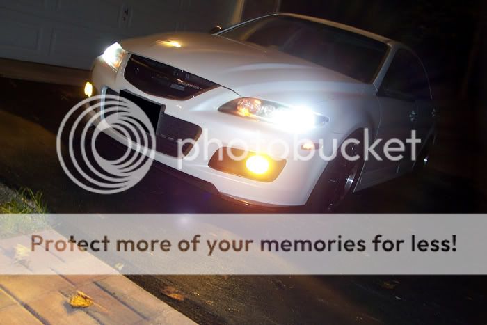

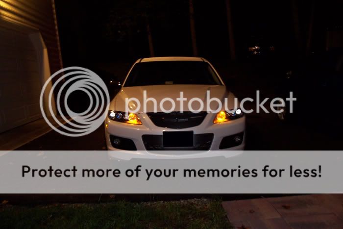

Tooks some pics tonight. Here are the Tower II amber parking lights.
Here are the frosted for the liscence plate.
Qwik, those ambers look good in the DRLs, and I bet they're a lot more noticeable than the plain white too. How do you like them in person?
I still like the softness of the frosted bulbs on the plate, but I think I like the colour a little better on those WLEDx5's that speed6 dude used. How do you like the frosted ones? I wish they came in a warm white.
The amber looks in person just like it does in the pictures.
The frosted ones arent too bright and a little bluish. I took those out and put it cool white like the ones you put in your doors. They look much better. A very clean white with better light output than stock.Since im stuck with only 1 red bulb I am going to use it in my boost gauge to light it. Should look very nice :)

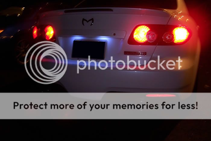

LED's in the tail lights.....
LED's in the lower rear reflector.....
LED's in the hatch third brake light.....

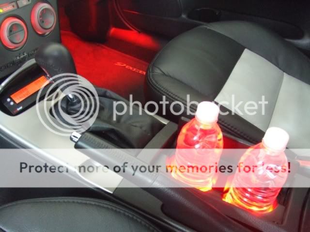

LED's in the cupholder, cold cathodes in all four foot-wells.....
32 inch LED strip in the hatch.....
Also got LED front side markers, LED's in all map lights, door lights, vanity mirrors, glove box, and for the license plate.

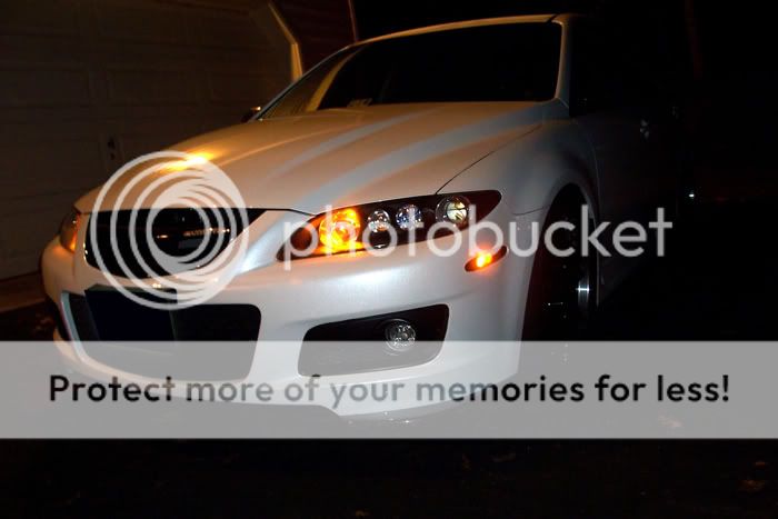

As for the parking light in the front housings, I installed these.....
I love lighting/electrical mods.....(flash)
Sexy. Love the tail lights. Are those glass neon tubes for the halos? I have a set but yet to install them. How do you mount them to the inside of the headlight?
those are cold cathode tubes, with out the outer protection tube.
they're made by umnitza (daylight demon eyes, or dde)
to open the housings, i bake them in a 220 degree preheated oven for 20 minutes.
notice, my eyelids are mounted inside the housing too.....
