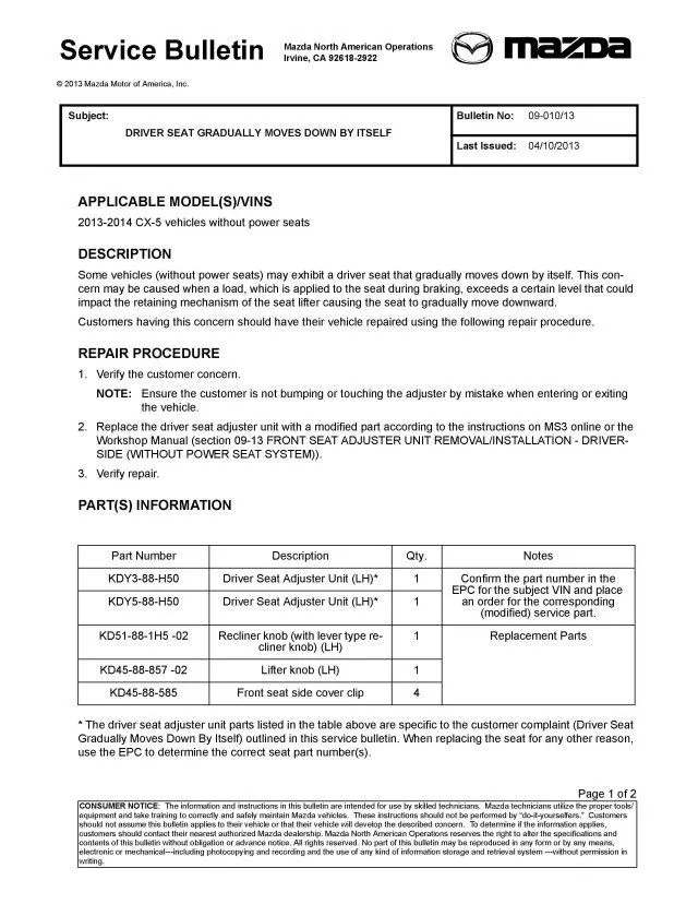

There is a TSB for manual seats lowering after some time.
When I get home I can get the complete TSB info for you guys.

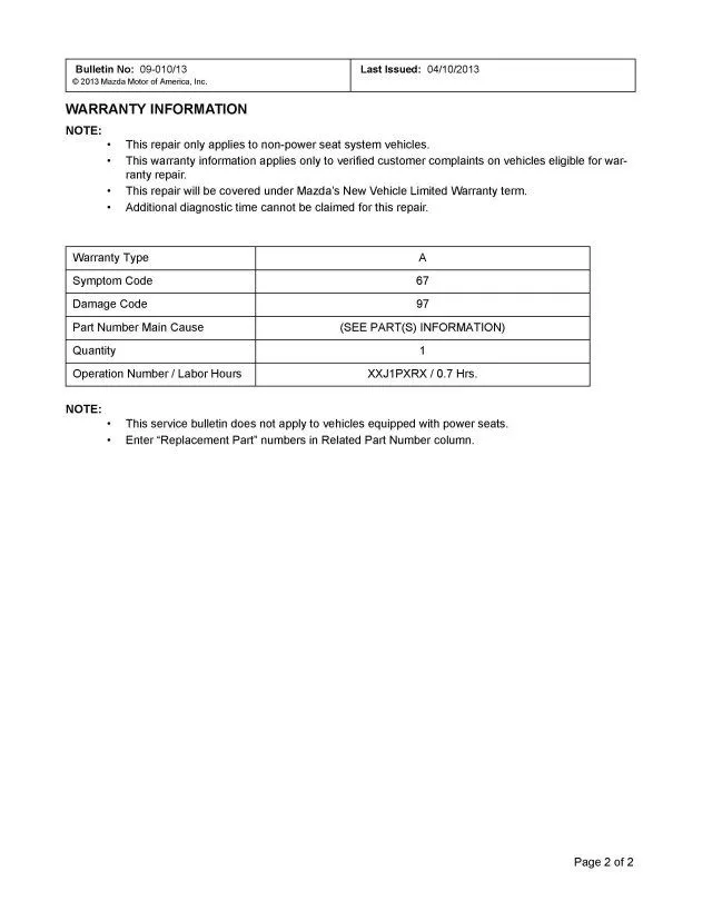

Here's a new TSB April 17, 2013, regarding NON POWERED SEATS lowering after some time.
Parts have to be replaced.
TSB is in picture format, click to view
TSB # 0901013
Page 1: Seat1.webp
Page 2: Seat2.webp
