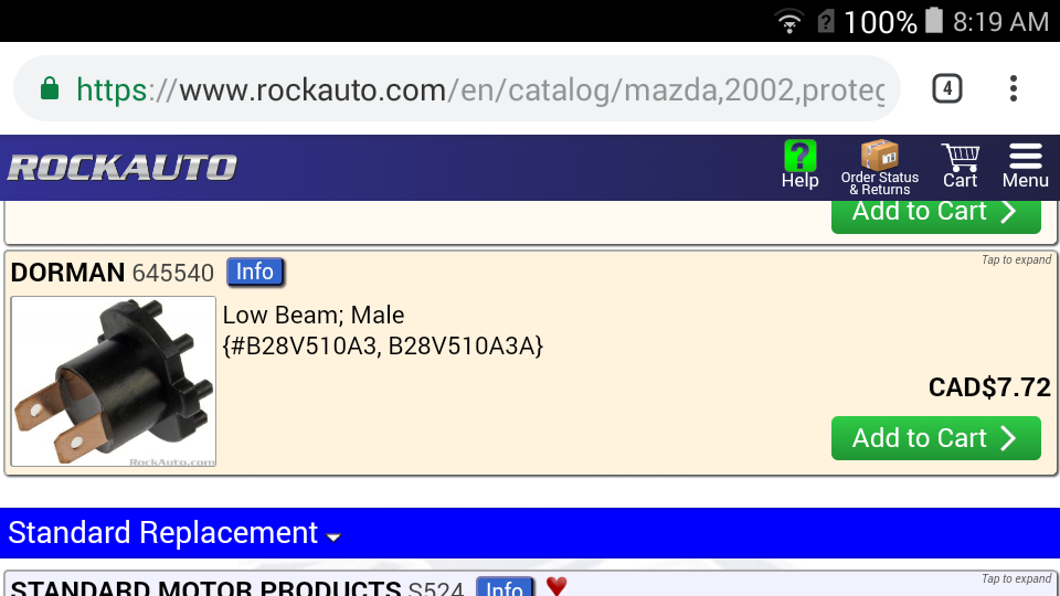

You might need a new adaptor.
They get all burned up and crispy.
A lot of guys here on the forum have problems with the bulbs burning out two or three times a year.
When I was driving my p5 daily I ate up headlights about once a month and had to get all new adapters for my driver side because crispiness
my issue is with the main headlight and that part doesnt look like the one for the main. its the light where you have to twist it and then pull it back. is there an adapter for the main headlight also? sorry for the noob questions... im a yung P5 owner haha
The bulb that you twist then pull out is the high beam bulb.
The low beam has the adaptor and is held in by a wire spring thing.
