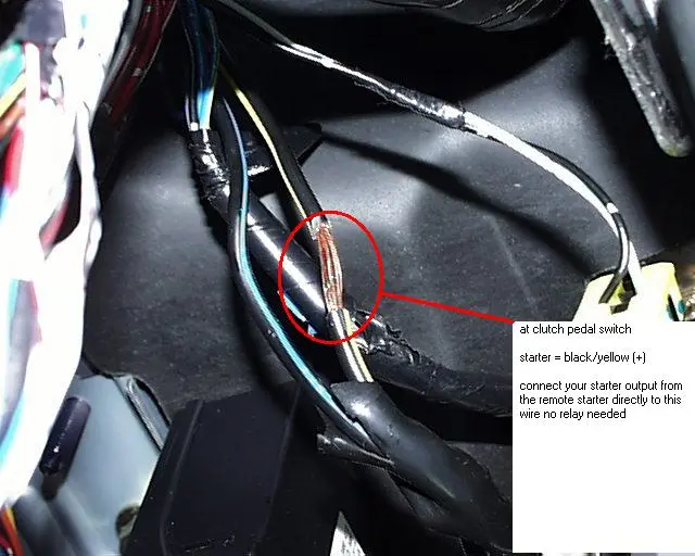

My boss did it on his jetta, im gonna ask him... So this in the morning when its cold and i want my car to warm up i can just reach in and turn it on.. or if im working on the car i can just reach instead of sitting down...
I agree with Dimitrios. If you are trying to disable it for a remote starter, all you have to do is tap the wire on the clutch switch above the pedal. That way the switch stays functional.
If you absolutely want to disable it, you would have to jump the wires on the clutch switch. I wouldn't recommend this, because the car could take off if you accidently leave it in a gear.

how do you tap the wire? and which wire do you tap? can you show us any way?
When installing a remote starter, there is a black wire with a yellow stripe above the clutch pedal that you tap.
If you just want to bypass it and you aren't installing a remote starter, there should be a second wire that you splice the black/yellow wire with. If you take a meter and test the wires it will be pretty easy to find. Since I don't have my car anymore, I can't look anymore, so maybe someone else might know off the top of their head.
ya im have a remote start i want to work. do its a black wire with a yellow stripe, isnt the wire bigger then the normal 14 or 16 guage thats used. what wire do i tap it with. the ignition wire from the alarm? thanks for the help man.
Yes, the wire is larger than normal. You connect the remote start output wire to this.
Turns out I had an old picture showing the wire. Enjoy!
