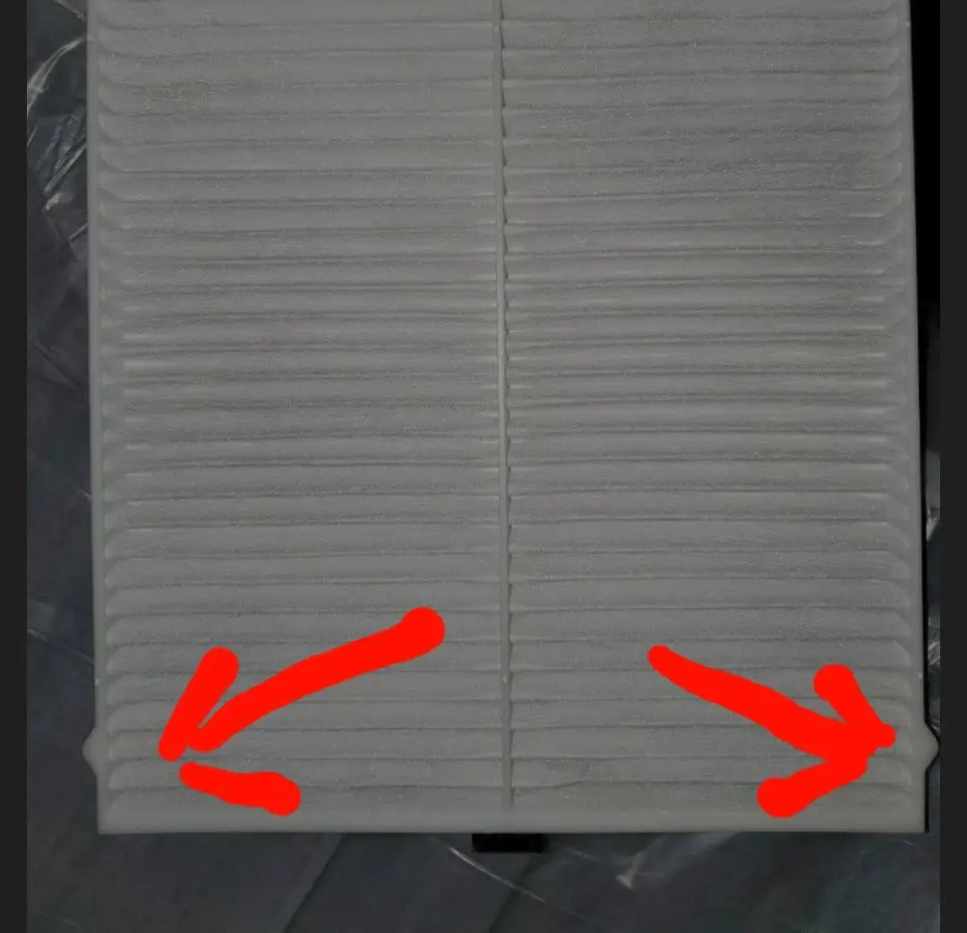

Dont forget to push it in. It needs to kind of click.. so that the two sticking outward edges on the side of the filter align in. Has some initial resistance then push more forward. Usually thats missed and it wont be fully inserted if its pushed until the first resistance.
I just installed the EPAuto CPJ6 filter from Amazon. One of the easiest maintenance jobs ever. No problems with the fitment at all. The only thing I will add is as cz5gt mentions, make sure that you push that sucker in firmly until you hear a good loud click sound which means the retainer tab has snapped into place.
