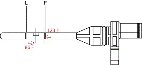

The best is to get an OBDII scanner to get proper ATF temperature when you check ATF level with engine idling:
Just an FYI that, if you have a Windows laptop, you can get the Forscan live data tool up and running on it for as little as $20. Forscan currently offers a free download of their software for Windows, and you can buy an inexpensive OBD adapter to read TFT (and a whole lot more as well). The Forscan doc states that they no longer support the lower-priced adapters, however they still work just fine for the simple stuff. This is a very easy and inexpensive way to get TFT the way the manual says to do it. But as always, your vehicle your choice.
Mazda specific OBD2 reader recommendations?
Finally, most members have found they need 3.75 quarts of Mazda ATF FZ for a simply drain-and-fill if you drained the ATF completely and check the ATF level at proper 122°F temperature with engine idling.
Here’s a schematic by @FerrariF1 showing how the ATF temp affecting the ATF level measurement:

Draining the ATF when it’s warm will speed up the process. The ATF temp is important only when you check the ATF level as stated in my previous post above.
