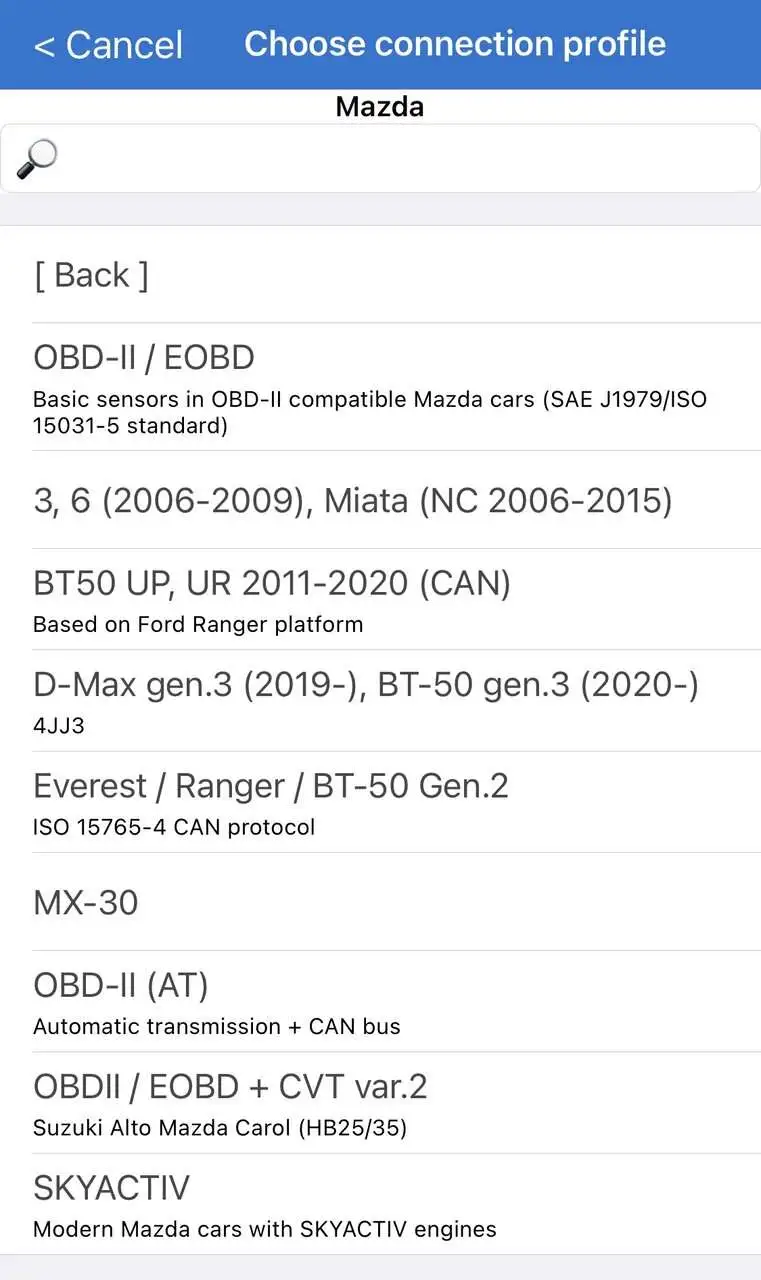

Trying this https://www.amazon.com (commissions earned) clone and iPhone app Car Scanner on my 2021 CX5.
Iphone connects to the scanner just fine, however the scanner fails to connect to ECU.
I tried the simple EOBD and it failed, SKYACTIV fails as well.
Is the problem with the device or scanner or car?
This approach worked on my previous cars.
PS will try FORscan tomorrow
Tried FORscan and it didn't see my scanner
Tried switching ignition on/off and Car Scanner managed to connect to ECU via D-Max gen 3 protocol

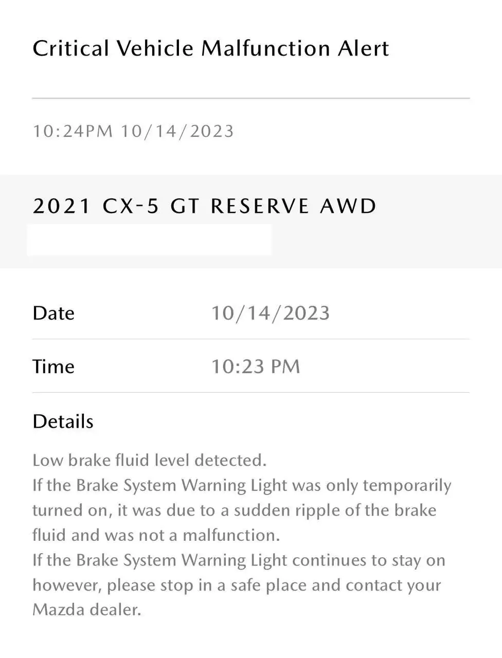

I don't see any error codes though, I was hoping to see something related to the message that popped up temporarily on car dashboard once after urgent braking
It went away and never came back but it's scary enough to expect to be present in ECU in some form
The message is still present in MyMazda app
