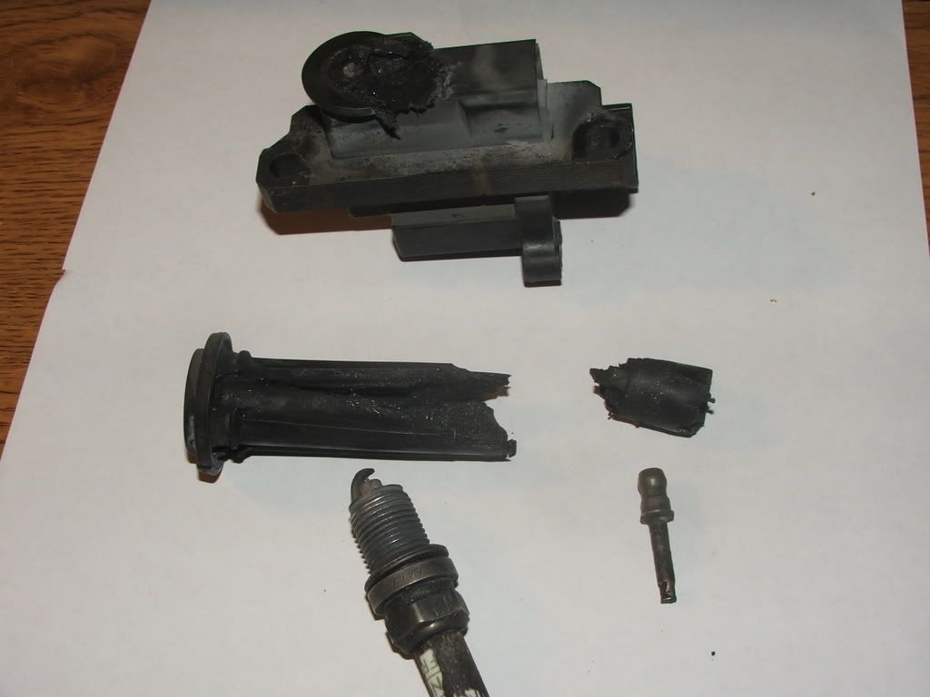

Alight, long story short. Spark plug blew in July, I replaced it, about a month and a half later, blew again, a week ago, blew again.
Last thursday I replaced both coilpacks, wires and all four spark plugs and I blew the same one again today.
I have been running the correct spark plugs and bought the coils and wires brand new. It's also Cylinder 4 every single time after the car has been ran a little hard for a few days.
Ideas? Please?

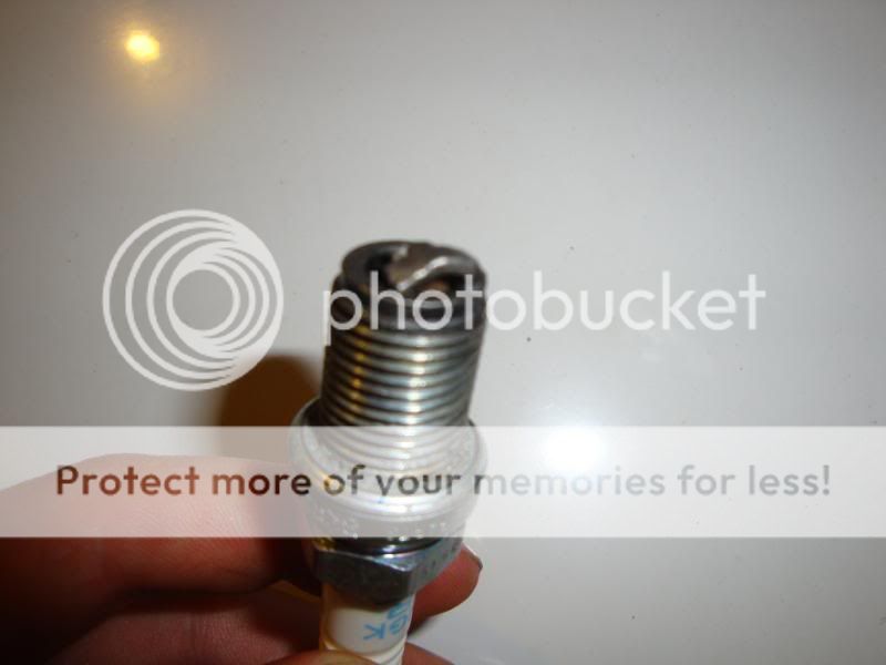

The spark plug keeps fouling, like completely blowing the tip of the plug so it doesn't work anymore.
I have pics of the previous ones.
First one
It was fused on the tip but we managed to gap it so I could use it to get to a parts store
Second one
Destroyed
Third one, didn't take a pic but looked alot like the first one. I havn't pulled the current one yet.
Wow that is a lot of info, picture is worth a 1000 words. Ok Look inside the cylinder if you see a shiny spot you hit the piston and you may have a damaged rod. Though I think you detonated, recheck your timing to make sure you didn't jump a tooth on the timing belt and that you are running a proper heat range plug.

For what its worth (and it may not be worth much since I'm no expert) I don't think its detonation cuz the color of all the plugs looks nearly textbook perfect. It looks like piston slap to me, like you're running a plug that sits so deep in the cylinder the piston is banging against it. You could have a bad wrist pin or something so the connecting rod is forcing the piston up too high. I used to race dirtbikes and would get piston slap right before the piston turned to shrapnel. I don't see how it would be timing... if it had slipped a tooth or two the car would run erratically with a brand new plug in there too. If the timing caused detonation then the plug should look melted down; not hammered. I would have someone look at the top end of the #4 piston to see if it looks nicked up from hitting the plug.
For the record, I hope I'm wrong, cuz changing out an injector would be a much easier fix....

thats not blowing up, blowing up is what both my 1.6l used to do...plug would get destroyed on the tip and also shoot up through the threads and destroy the coil. Never traced down the problem. Had one local guy tell me he had only seen that when someone had a stressed and stretched rod, however my motor went for thousands of abused miles after, until finally the crash.
Now THATS what detonation looks like!
WOW.
