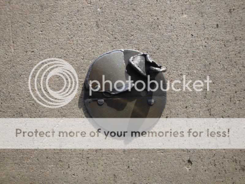

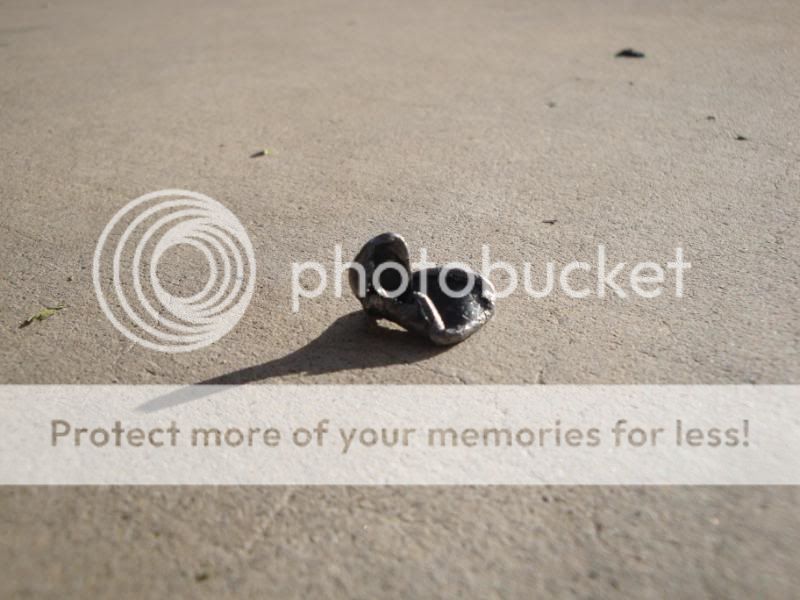

Ok so I picked up a normal magnant wand from my lovely gf since the one I bought was too fat and was able to actually stick it all the way into the cylinder. As soon as it went in "tink" so I pulled it and and what do I find?

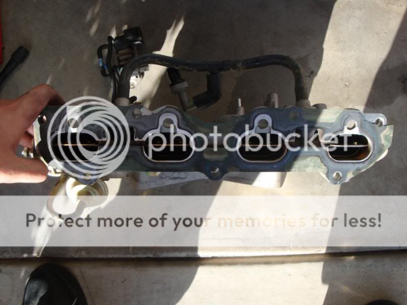

My first thought "What in THE **** is that?" So then I started undoing the top of the IM to see if the butterflies were still in tact. Pulled it off to find this...
Hmm, ok? So all the screws and butterflies are in place? I flipped the IM over to see the other side...

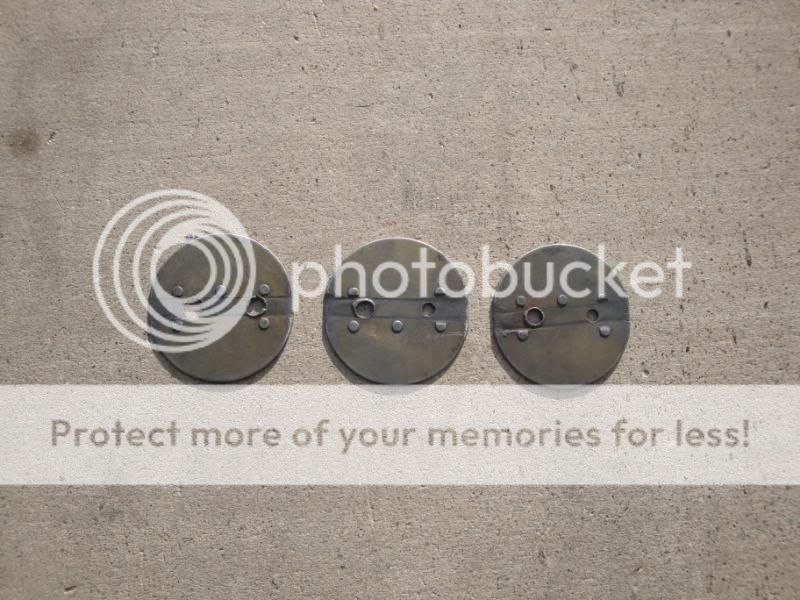

2 screws missing. Those are tiny screws though, they couldn't of made all that metal I found in the cylinder. Then I realized, wait a second, those screws are suppose to be holding something! So I run my fingers inside, nothing. Go back to the car to check out the bottom part and...
WOW! Are you serious!!
They were just chilling there, totally loose. I couldn't believe it! Wait, a second, wheres the fourth one? More digging...
WOWOWOWOWOWOW!! 3 quarters of this ****** are gone! This must of been slowly been letting little pieces inside my motor over the last couple of months!
Well, I can't see any damage to the top of the piston, so I'm gonna put everything back together, remove the screws and butterflies, do a compression check to make sure everything is cool, and hope thats the end of this stupid ass problem.

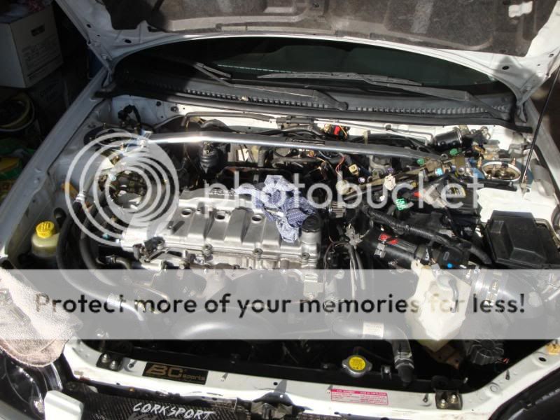

As she sits currently
