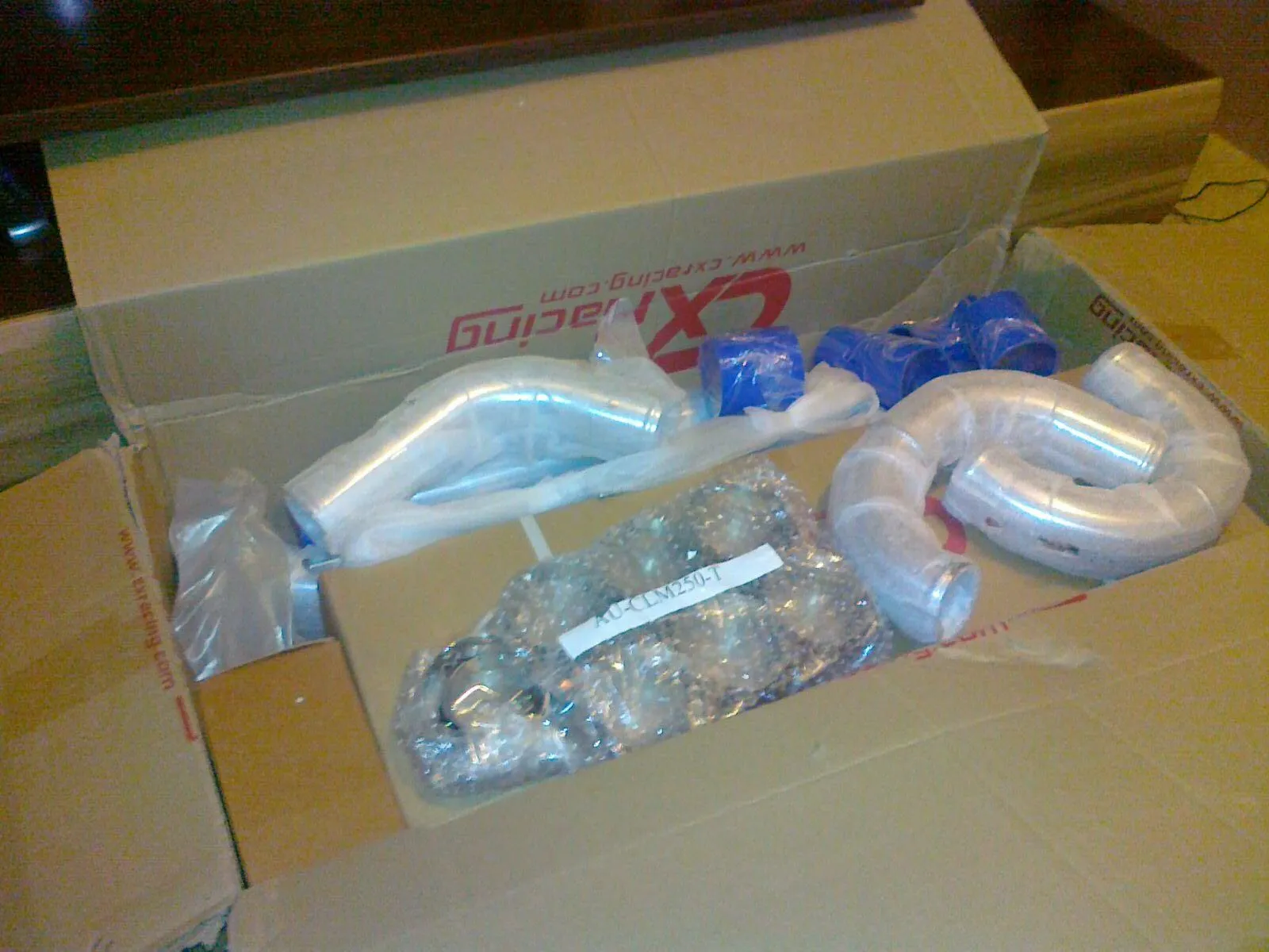

I just got my cxracing kit last week and I have to say the quality of all the piping and the core looks amazing! From what I've heard it is the same as the pg kit as far as the piping route, but in comparison to pics I've seen of the pg kit and from what I've heard, the quality of the cx kit is a little better and fits better. And the cx kit also comes with a bpv. I will post my performance results as soon as I get it installed.

Everything what is said above is true. Quality is better then PG, BPV flange is also better oriented and tapered for Greddys and stock flange. Brackets included are also nice. Clamps are T-Bolts, so no problems, every pipe end is rolled.

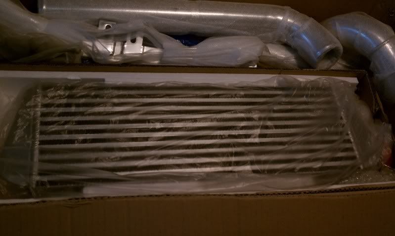

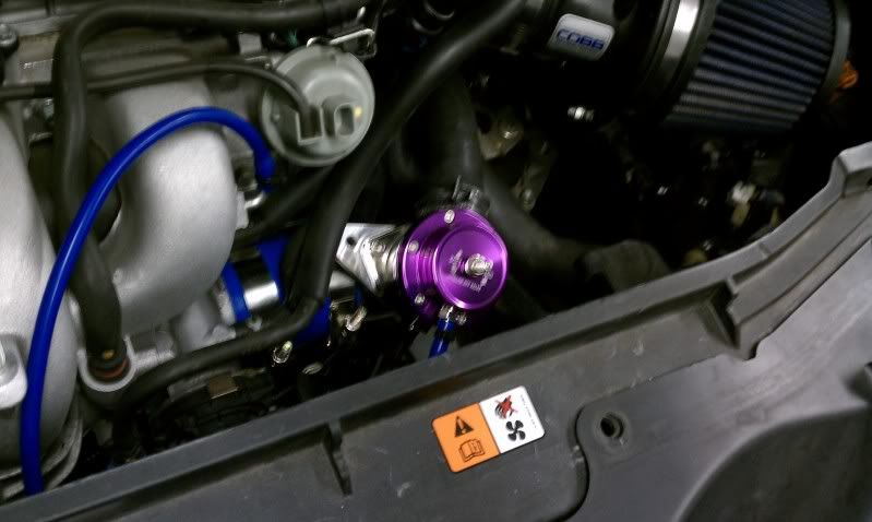

I ordered a FMIC kit from CX Racing and recieved it just the other day and it looks awesome (haven't installed it yet though). Just wondering if anyone has used the stock BPV on this kit? I am using the COBB accessport tuner and on the MAP notes it says to use the stock BPV only. Doe anyone have any experience with or know if you can get away with using the COBB maps with an aftermarket BPV such as the one that comes with the CX Racing FMIC kit or should I just stick with the stock BPV? Are there any performance issues with using either the stock BPV or the aftermarket BPV with this FMIC kit and the COBB maps?
You shouldn't run into any issues as long as the valve is recirculated.
the bpv must also be tuned so it doesnt leak. that is why cobb says that because they can only guarentee through testing of stock, that the ap will behave the way they want. i use a greddy rs bpv and have no problems just make sure its tuned correctly.

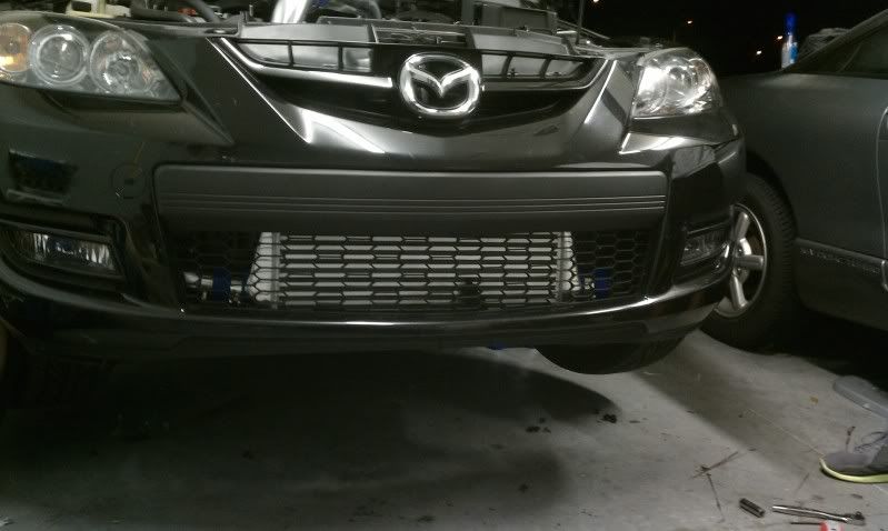

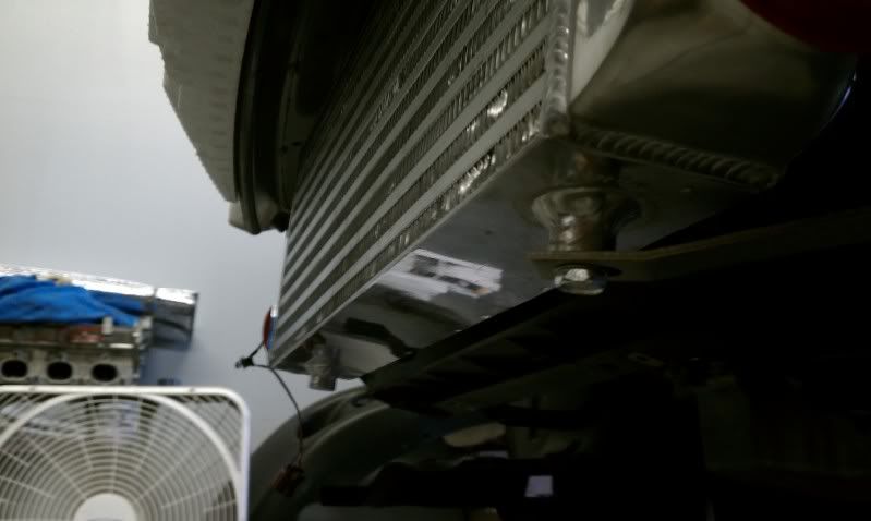

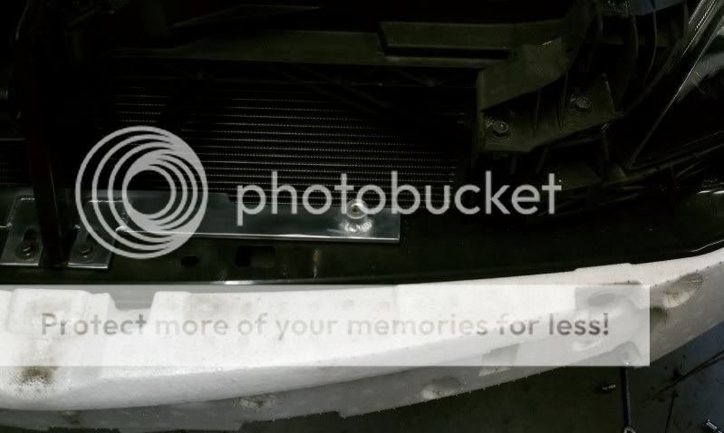

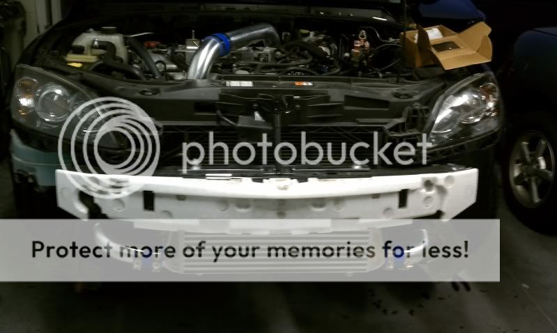

Ok, so I finally got around to installing this thing.
Mark from SU was kind enough to take the time to help me with the install as well as provide a place to do the work(his garage) since I live in an apartment complex.
Only problem we had really with the kit, was they only sent me two mounting brackets for the core instead of four. If you look at the last three pictures you'll see what im talking about. So what we did was just put one on the upper left and one in the lower right of the core and it should hold just fine like that untill I can get ahold of the people I bought it from and have them send me two more brackets. Im not too worried about it though, because the core is pretty snug in there as it is even with just the two brackets it seems fine. One more minor issue we had was that one of the t-bolt clamps that came with the kit was a bit too small so we just used one of the clamps from the stock boost tubes in its place. Other than that, all the piping fit perfect. And no cutting, or moving of the powerstearing lines whatsoever. Whoever designed this kit definately put some time into it and did it right. The bpv that comes with it is a greddy knock-off and sounds pretty good. A little stockish sounding but a bit louder. The stock bpv will also fit with this kit if you deside to just stay with that. it also comes with a black vacuum tube for the bpv because the stock one wont fit with the smaller vacuum nipple, but Mark had an extra blue one laying around so we just threw that on there. the entire install took us about 3 1/2 hours. We probably would have been done a lot quicker if Mark didnt keep loosing tools and droping screws and sockets into the engine bay, lol. I have to give him all the credit though cause he did most of the work. Those guys over at SU definately know their s*** when it comes to these cars. He even said that he is gonna start recomending this kit to people even though they dont sell it at SU.
As far as the performance, it feels amazing! Seems to pull a lot harder up top. I'm sure once I get a Hypertech or some kind of tuning, I will get even more out of it.
If anyone looking into this kit has any questions, just holler!
