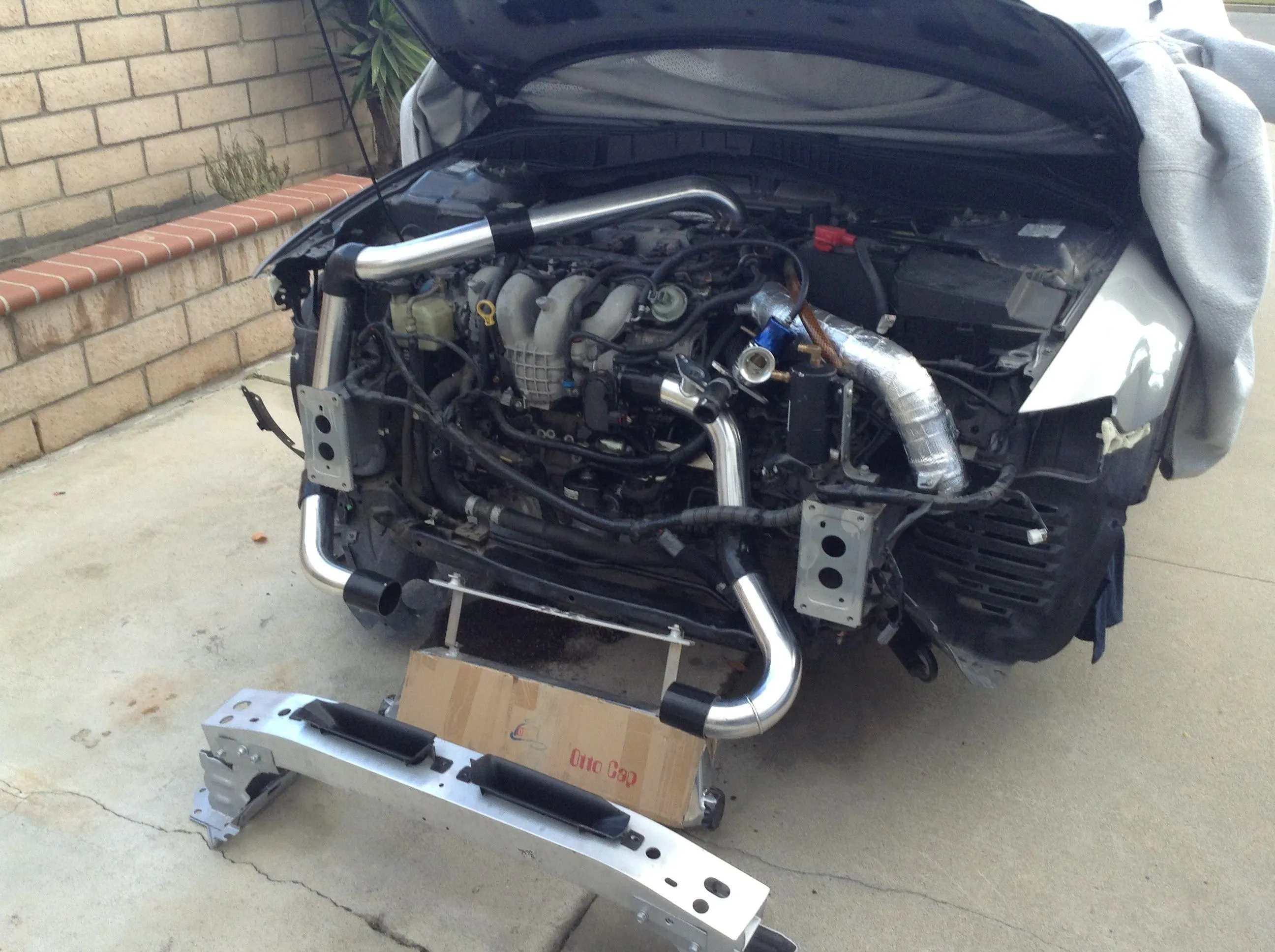

This is one of the most efficient designs if not the most efficient design out there! I did all of the math/ engineering and the building myself and can assure anyone that it will add power and efficiency to your setup. It has worked perfectly on my car and can be setup in many different ways for blow through setups or regular upgrade situations. Keep in mind im not a professional shop with all the best tools so some of my cuts could use finishing but it will work perfectly as is.
My setup has been now duplicated by many on the forums and tested by many proving the power gains!
All of the cutting and test fitting has been done as its been on my car for about 4500 miles. The intercooler and piping are all in good shape and work perfectly. BOV pipe and BOV will be included. This setup can be run recirculated or open. Ill even send some extra piping and couplers so you can run the setup however you like! Please contact me for details or questions.

DIY FMIC
Core Size: 22 x 7 x 2.5 = 385
(25.714 % Increase in core size over stock)
Air Inlet Size: 1 x (28 x 10) = 280
(Front Air dam 10X the contact area for air)
So as you can see even a budget DIY EBAY FMIC seems to be a WIN over the stock TMIC fo many reasons. The core size can be increased, along with the area in which air can travel to hit the IC, also heat soak (obviously). Now the qualtity of the parts im using is up in the air but i can always upgrade in the future to increase the efficiency of the setup. Also im hoping that Ill be able to keep my pipes cool enough to actually be utilizing that travel as additional cooling to the charged air by using heat wrap, tube blankets, turbo blanket, and i already have a vented hood that really keeps down ambient under the hood temps, especially in stop and go, or in the mountains. I also plan on directing and focusing the air still coming from the stock ducting system to cool the top pipe coming across the engine. Comments and concerns are welcome. I love working on cars and fabing things so Im sure i can tackle this, Im just excited to document it and see how it turns out!
