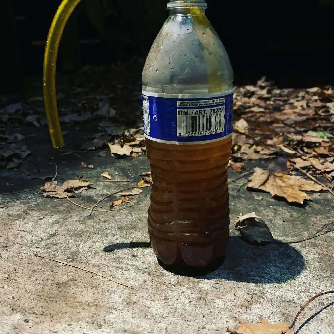

2019 CX 5 Turbo, with Corksport OCC.
No regrets, I change oil myself about every 3500 mi (I'm extra and I do drive frequent, short trips less than 15-20 min, and usu very spiritedly). This is what I usually get from the OCC. 💯
Looks like 95% water, which to my point means the catch can didn't catch much oil, which is ostensibly, the reason you go to the effort of installing one in the first place.
