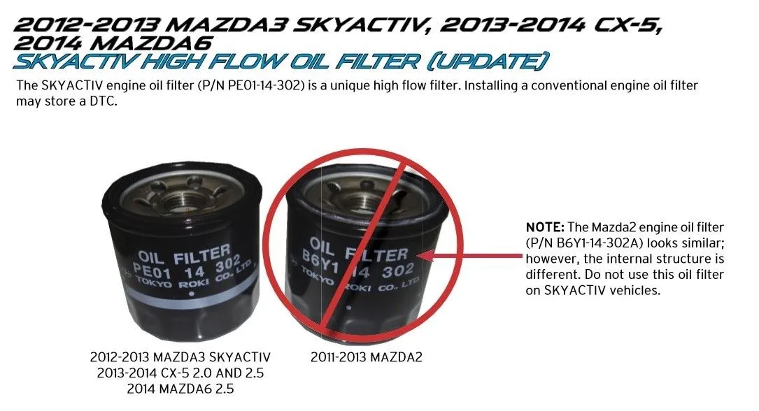

Obviously both FRAM and Mobil 1 oil filters are one-size-fit-all while Mazda OEM oil filters have different specs for different engine requirements.
Here is an official document from Mazda North American Operations stated that don't mix OEM oil filter used on Mazda2, although it looks similar, with CX-5 SkyActiv-G engine althiough aftermarket filters usually use only one to fit all:
Just want to throw this in here, DO NOT use a non genuine Oil Filter in any Skyactiv Engine, diesel or gasoline.
These oil filters are specifically made and designed for Mazda by Tokyo Roki.
Non genuine oil filters do not have the correct by pass and flow rating.
Using the incorrect Oil Filter can also throw up DTC's (Diagnostic Trouble Codes, 'CEL' light on dash)
See PDF from Mazda USA ( for SA-G)
Since the original pdf file is an attachment and has been missing for a while after our server update, I took a screen shot and post it here:
attachment.php

In addition, OEM PY8W-14-302 oil filter for 2.5T is different and more expensive than OEM PE01-14-302A/B for 2.5L although both are made by Tokyo Roki. This indicates Mazda has designed a different oil filter for more powerful 2.5T. If you worried about small size of OEM filter used on 2.5T, you should really worry about those after-market oil filters which use one model to fit all different kind of Mazda engines!
That is interesting information about the PY8W-14-302 being specific to the 2.5L turbo engine. Since we don't know what the bypass and flow rating of the Mazda filter is vs. a Mobil 1 or Fram Ultra for example it may be wise to stick to the OEM filter.
