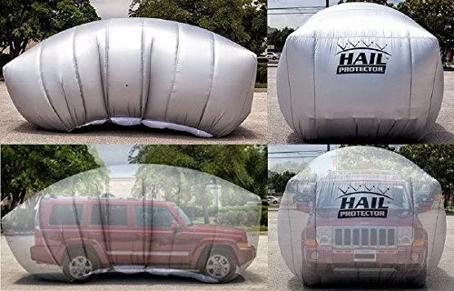

Nope. You'd have to put the entire car in a tin-foil pouch, as it contains the receiver, not the FOB.
...You'd have to put the entire car in a tin-foil pouch...
Not so far-fetched.
Plenty of inflatable car covers. Great protection for winter storage.
But AFAIK, no one makes a faraday cage version.
haha that's funny...just what I want to do every time I park the car...
